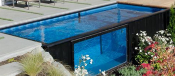

In one of my many jobs we built big square plastic tanks for chemicals. We had to have a lot of steel bracing wrapped around them, I'm sure those containers need support, especially if they aren't below grade.
I watch the youtube videos on why containers aren't really good for much outside of storage, they really need all four sides to be structurally complete, when you start cutting stuff off, you better reinforce it.
