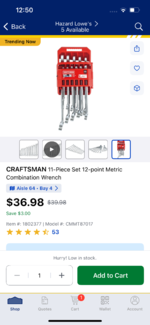

Here’s the top two trays of a cheap cantilever box I set up for working on farm equipment. Metric 8-19 in one side and SAE 1/4-15/16 in the other side. It saves space and I’ve found it doesn’t really slow down my work flow. I’ve got some larger wrenches in the bottom of the box as well. When I set this up I intended for it to be a mobile kit to handle breakdowns and general maintenance but it’s pretty much turned into my go to set of mechanics tools. I find myself working out of it even in the shop.
The other picture is a cheap set of Duratech metric wrenches I bought as spares. I’ve come to really like that style of holder as it’s easy to grab and take the whole rack. The down side is they take up a lot of space in a bag or hand carry box but if you’re just tossing them in a truck tool box or into the floor board they work well. This set usually hangs on a nail above my work bench. It’s what I grab if I know I’ll need a second set of wrenches
The final picture is a Craftsman set available at Lowes. This is a sat that stays on my truck. I’ve had a set of these for several years now and after thousands and thousands of miles of rough rural roads I’ve never had a wrench come out of the holder.

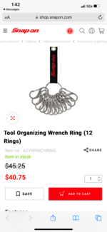

I have a set of wrenches in a holder and then secured with a velcro cable management strap. It is similar to the Tekton you posted, and it keeps the wrenches in the rack when traveling.
Wiz02
Jul 13, 2007
2,399
Southeastern PA
I've never seen the HF D rings before and they look like a better solution than Dad's which was a length of all thread with a nut and fender washer to hold the large wrenches and just a wing nut or maybe a nut and washer on the small wrench side. Can't remember if he tack welded the fender washer to the nut or not.
It was a cheap, compact solution, but you were always unthreading and threading a nut to access a wrench.
Kurt4440
Jun 3, 2009
2,511
Western New York
My father had a set of combination wrenches with this style clamp/clip to hold them together. He kept them in his travel tool box. I keep my travel wrenches on a Harbor Freight spring clip.
