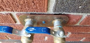

What happens to silicon-bronze filler rod when it is used in an outdoor, 4-season steel installment? I'm working to design some things for around the house and want to add some flair with the gold-coloured filler rod, think planter boxes and house numbers and such. Is it going to weather weird? Or stay bright & shiny? Will freeze-thaw cycles make it fall apart? The parent materials to be TIG brazed are either mild steel or Corten A588 weather steel or stainless (409 or 304).

Brazing done to a properly done joint is stronger than the steel. Brazing rod itself has strength from the 40k to 85k tensile strength. But a properly lapped brazed joint will be stronger than a welded joint due to surface area.

It works and holds well. It doesn’t really oxidize like the steel. It is such a slow color change. You can also use high nickel rods for silver color.
