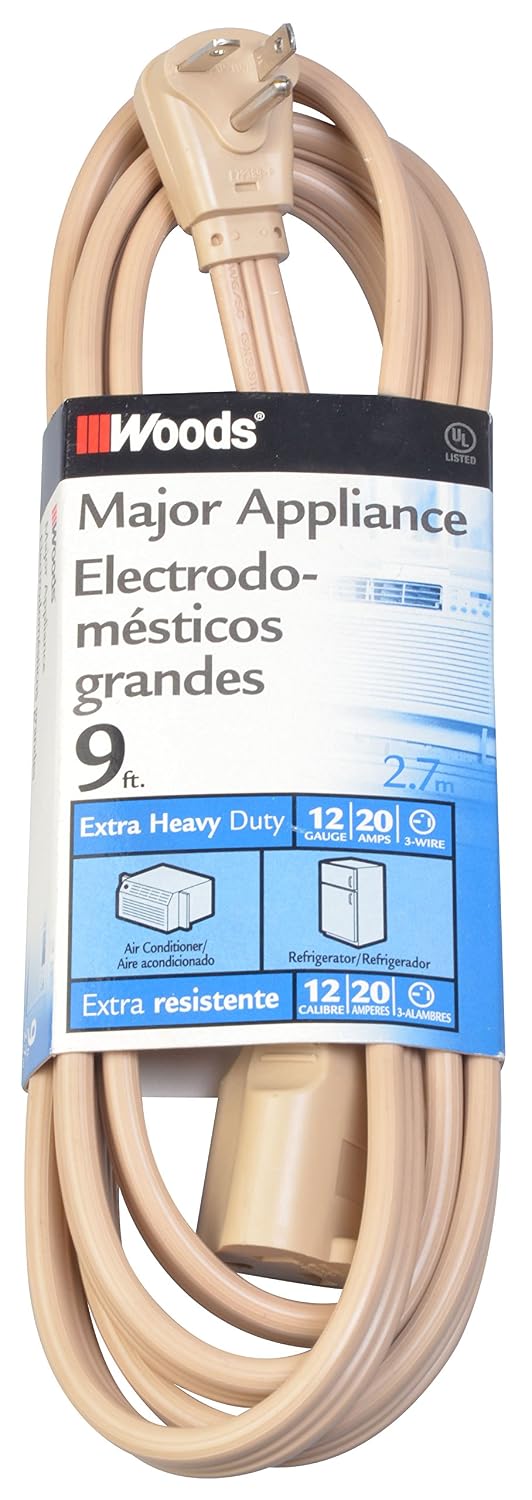

So I have a lift woohoo but the power since it is a 110 volt motor is 15.7 amp! The outlet that is closet to it was a 15 amp circuit! Not comfortable with that being the draw for running the lift!
I have a 20 amp circuit but need a cord to connect form the outlet to the plug for the motor(standard 110 plug). I went Home Depot to try and find something to make it work and they had bladed plugs rated for 20 amp but they are bladed opposite of the appliance cord I found. I am confused at how to get this connected from the plug to the outlet without a **** load of connectors and cables. Anybody with some knowledge here jump right in....
Trying to do this myself without paying for an electrician!

Make up the cord. Use 12/3 SJEOOW cord and a Hubble 5-15P plug and 5-15R socket. Actually 14/3 cord will be enough if it's not a long cord.

Want to go with an angled plug up against the wall and use a cord cover across the floor then connect to the plug shown, the tag shows the motor information.

Ok, so you do have a 115vac motor and is draws 11.2a at 60hz - not 15.7a. So this must be a non-standard motor offered from Bend-Pak based upon their current website info. This is good for you.
So that motor loading is good for a 15a circuit if it doesn't have too high of an inrush and combined with whatever else is running on the same circuit. I would start with the 15a circuit as you show pic of and worst case you need to move to the 20a circuit you previously mentioned.
As for extension cords, not sure where your difficulty is. Buy a 14-3 cord with 5-15 cap and plug (15amp, 120vac, 2 pole, 3 wire) and your should be good to go. Length may be your only challenge - too short, too long.
If you can't find a cord with a right angle plug, make a cord up yourself or cut a pre-fabbed one to length and put a 90 degree plug on the cut end.

No my issue is with finding a 20 amp rated cord to connect from the outlet(which is 20amp rated) and connecting to the current plug for the motor. it is a standard 110 plug. I can find a lot of 15 amp rated cords but nothing 20 amp rated.
I guess I may have to go to an electrical supply house and make my own just specify what I am trying to do.

@ This is what we are trying to say but it must not be clear. You do not need a 20A cord or ends. The 15 is fine, it does need to be on a circuit with a 20A breaker.
In many cases a 20 end is used to keep the user from plugging it in to General circuits where a trip may cause other problems or the circuit is being shared with other equipment.

Anyways, your motor is only rated for 11.2 amps on 60 Hz AC power. A 15 amp circuit is just fine. I've never had an issue with 1hp motors on 15 amp circuits.

I guess I just need to build a cord for the connection between the two is all. Friday I am hitting the supply house to get it finished up.
Is the cord I referenced in post #22 too short? It's going to cost you more to make up a cord than to buy a premade one.
