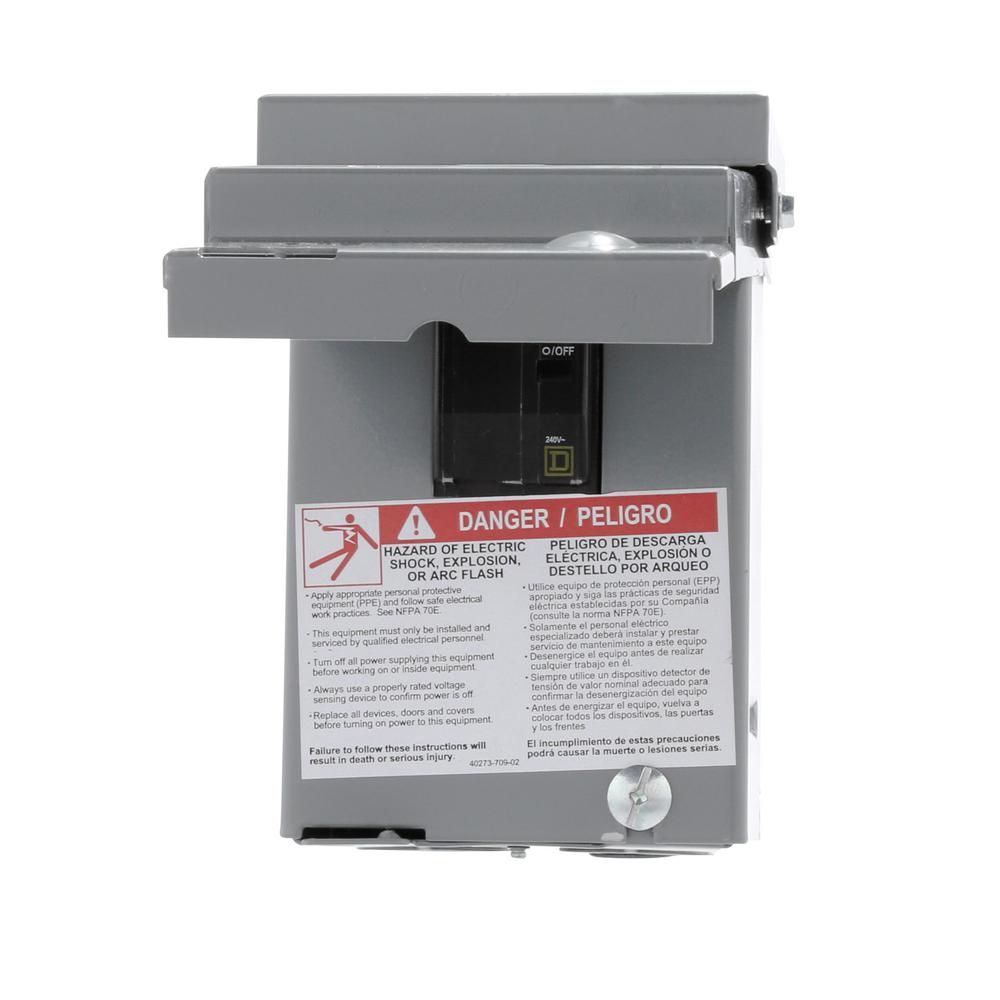

How did you wire that compressor On/Off switch? Does it control the contactor via the coil? If so, you just need to put the pressure switch in series with it so that either can break the control circuit. If you are breaking the power from the panel directly with the switch, then that won't be an option.
TR, it's a HD 60 amp non-fused power switch; somebody posted about it in another thread.
Pic and link: https://www.homedepot.com/p/Square-...kW-Non-Fuse-AC-Disconnect-QO200TRCP/202353314

That switch is killing the entire supply to the compressor. If you follow that Eaton diagram for the pressure switch you'll be in business. The control logic is the same.
That's the point. Other than providing power it doesn't control the compressor.
