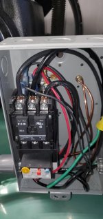

I just had my cousin wire up my speedaire 4xa59 with the eaton B27CGF30B040 5hp 1 phase starter box.
He couldn't figure out how where to connect the pressure switch to on the starter. On the pressure switch both wires are on one side and in the diagram on the switches cover it shows a wire on each side. Then I saw someone say to connect the wires to the L1 and the other wire to the connector behind L1.
Anyone familiar with this? If I push in the coil button it works great.

It appears your cousin wired the load side wrong. The motor connections should come off of here, not directly off the contactor. The wires will have to be moved to T1 and T3.
As for the pressure switch connections, one wire will connect to L1, and the other one will connect to the terminal behind it.
The coil is 240 volts, and half of it comes pre-wired. The pre-wiring takes 120 volts, runs it thru the overload controls, and to one half of the coil. The field side is the switch, so you will tap off L1 to get the other half of 120, go to the switch, and connect the wire returning to the other half of the coil, which is the terminal behind L1.
You'll also have to set the overload dial, it's the little yellow dial.11d039dafa1f3aeb8a87b9782e916e64.jpg

The pressure switch is wired correctly per the embossed label on it
however, the motor wires are incorrect.
You have no overload protection because whoever wired that connected the motor feed wires to the bottom of the contactor instead of the overload relay
Need to move the large wires down to the overload relay- T1 and T3. Looks like there is already a jumper from T2 to L3 which is needed to prevent tripping of the overload relay since you are using a single phase motor and that is a 3 phase starter.

Right now the wires from the motor are on T1 and T2 and the supply wires are on L1 and L2.
That's what you guys are seeing correct? The supply wires come in from the left lower side and the motor wires come in from the right lower side. The pressure switch wires come in from the bottom right side. Just want to be sure

On the pressure switch, both wires need to be either on the L1 side or L2 side, not one wire on L1 and one wire on L2. The way you have it is fine.

I wired up like you guys said and when I turned on my disconnect box to supply power to the magnetic starter box I was expecting the compressor to turn on automatically but nothing happened. I think it's because the pressure switch says min. start 100psi
I can start the motor if I push in the coil button but I'm waiting for the replacement tank outlet valve to arrive so I can get the tank to hold pressure. Do you guys think it can be this?

It appears that its wired correctly.
Did you turn the pressure switch on? If it's in the off position it will not run.

Looks to me like you have both sides of the pressure switch connected to L1. You do not have a complete control circuit from L1 to L2.
It looks right to me. The coil connection is directly behind the L1 terminals. But it's hard to tell from the angle of the photo. I would check would be if the pressure switch is good, considering I believe it's a used compressor.
that may be the issue.
If the coil is 240v, then one side of the coil should be connected through the overload relay to L1, and the other side of the coil should be connected through the pressure switch to L2
The pressure switch comes set from the factory to turn on the compressor when the pressure goes below 140 psi and turn off the compressor when the pressure reaches 175 psi. There is a differential of 30-40 psi between the on and off setting. The "min 100 psi" means you can adjust it down to start at 100 psi which would then equate to between 130-140 psi when it stops.
Adjustment screw A shifts both set points at the same time the same amount. Adjustment screw B changes the lower set point higher or lower while leaving the upper set point where it is.

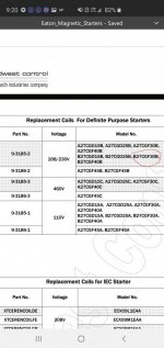

Not yet but I'll try to work on it tomorrow morning. I'll try to see of it's a 240v coil but I think it is
I looked up the starter and I found the brochure or whatever this is and it had this on one of the pages.
I have a Eaton B27CGF30B040
