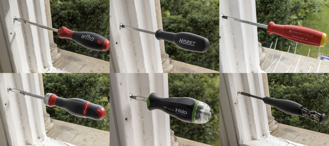

The Weras with the laser etched tips are crazy. They grip really well. You can insert the tip into a horizontal screw and let go of the screwdriver and it will not fall out. Not my picture, but:
For fun, some alternatives. Had to try a few screws to find a tight-fitting one but then all drivers/bits I tried fitted well enough to stay attached. The last one drooped a bit but it's a ratchet screwdriver full of bits so quite heavy. :)
I can also confirm that Vessel drivers will also do the same :)
