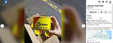

Johnsons paste wax but holy **** apparently discontinued and it's selling for ridiculous prices. I'm sure any paste wax will work but Johnsons was good at not transferring and affecting woodworking finishes. I've used boeshield for longer term protection. Fluidfilm would probably work too.

I found some of the Johnson paste wax at an estate sale a few months ago

I use fluid film. It is easier to apply than paste wax. I found paste wax at an estimate sale. Saving it to pay for kids college 😂

What makes it ridiculous is there there are MANY excellent substitute products. Look for bowling alley paste wax. Lundmark's is what I used to use.
I've moved over the Renaissance wax for everything now.
^^ This. It doesn't have to be Johnson's brand.
Here's a reasonably priced Minwax brand I just found on Amazon. Whatever you get, just make sure it's a carnauba-based wax.
Note that once you have a 16 oz. can, it's probably a lifetime supply. My can of Jonnson's is probably 40 years old.
