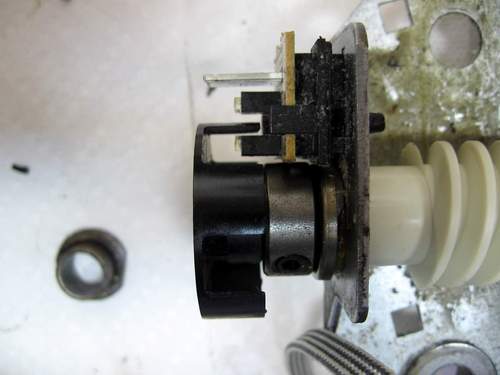

Motor overheated/Possible RPM sensor failure -- unplug to reset

10. Door starts to open/close only travels 8" then reverses/stops: • Forces for up/down set to low. Pull emergency release and check manual door operation. If no obstruction, increase force and retest.
• Interupter cup not properly seated on motor shaft. Visually inspect the interupter cup to insure proper installation. Repair or replace if necessary.
• Defective RPM board. Replace and test.

The RPM sensor and Logic Board are two separate components!
First check to make sure the RPM sensor is connected properly(sensor is small board with 4 or 5 prongs and a black u-shaped piece of plastic) Make sure its seated properly on its holder and plug is on correctly, then make sure interupter cup is seated all the way down on the shaft.(black cogged wheel)
Next make sure Logic Board plug is on correctly and seated down all the way! If not, this can cause false RPM reading. Good luck!

FIXED!!!! Thanks for all the advice and council.
Here is what it turned out to be:
1. The bearing was shot. The bearing, shaft, gear kit fixed that.
2. The RPM sensor was bad; as a number of you indicated.
What kept me from identifying a bad RPM sensor was that there is a ceiling light right behind the opener. When it was on, I couldn't see the green LED flashing five times which indicates a bad board ... either main circuit board or RPM sensor. The tolley moving 8" and back to starting position again is what confirmed the RPM sensor.
