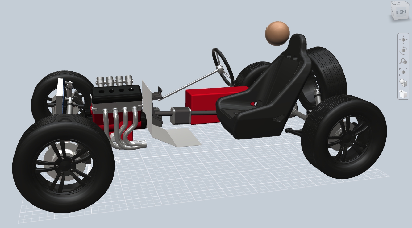

last winter i worked on a CAD of a "retro-modern" interpretation of it
here are some screen shots;

i started a new CAD based on the clever "off-set" drivetrain layout of the Austin 7S...
..but this time with a shorter WB and a wider & shorter body/hood
more in my next post ;)

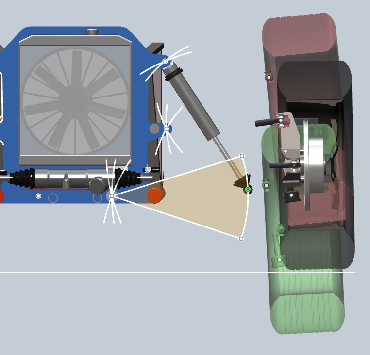

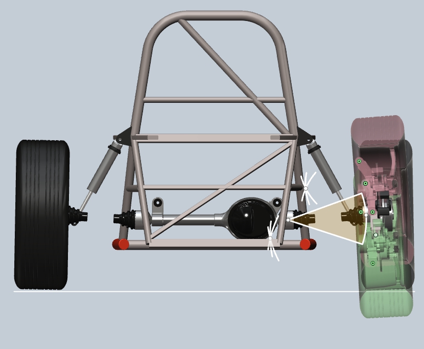

but i think on this project i`m going to stick to what i`m experienced with;
basically a "light" variation of the I- and H-arm IRS that i used on several other projects already.
i got it already drawn with all the pivot points established
high resolution; http://www.supermotors.net/getfile/1036467/original/rearsusp2.jpg
i prefer the I&H arm over a traditional double A-arm for "packaging" reasons
it is also a low CofG design with the beefy H-arm low to the ground and only a slim upper link
i used the same design on several cars , like on this front engine buggy i build over 10 years ago;
iirc i should be able to get about 11" of travel out of the stock Explorer axle shafts ...
custom axles would net more travel
but i try to stick to stock "off the shelf" parts as much as possible fore ease of replacement and to keep the $$ down
that is also the reason why i plan on using mass produced unit-bearings and brake discs.
only the brake calipers will be (aluminum) aftermarket ones

for example i may post a screenshot from when i set up the rear suspension layout;
i set the ride height at a slight negative (inward) chamber
the full compression (red) is set with lots of chamber gain to fight "wheel scrub" (track dimension change)
it also helps me to keep the tire vertical to the ground in a high G turn
(when the body leans into the turn)
i added also a lot of chamber gain for full drop (green)
again, mostly to fight wheel scrub on very rough roads
the green chamber gain is usually putting the outer CV joints to the limit of its travel,
but the nice thing on the explorer front "steering" axles is that the outer CV is a non plunging one (it allows a high degree of angle for tight turning)
my suspension travel limiting factor is actually the upper tripod joint...
very similar chamber changes are also designed into the front axle;
again, mostly to fight scrub (however, i had to compromise on the full drop due to balljoint & heim travel limitations)
