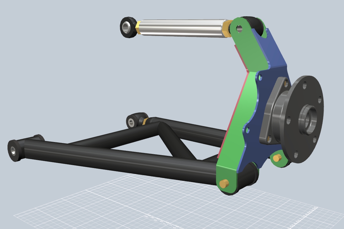

... Should I assume that the red and blue parts are 2 separate pieces ? Are you going to use a press brake to fold them and then weld them together ?
I probably don't need to say this but, make jigs to verify critical location points. I would at least cut out 2 of each.
as drawn the spindle is actually made of 8 pieces with two spacer tubes (at the upper UB bolts)
and a block of 6061 T6 aluminum (at the lower bolts & the balljoint)
lots of welding, but with the holes in the plates i should be able to weld them mostly on the inside,
with only a small filet weld on the outside
i do have a friend that is in the Waterjet business (and is interested to get a copy of the buggy for himself),
so cutting the parts should be not a big problem.
yes, i plan on building jigs wherever needed
however, i also plan on several areas to be "self-jigging"

as drawn the spindle is actually made of 8 pieces with two spacer tubes (at the upper UB bolts) and a block of 6061 T6 aluminum (at the lower bolts & the balljoint)
Green on the other drawing, correct ? Are you going to sleeve the hole for the ball joint stud ?
lots of welding, but with the holes in the plates i should be able to weld them mostly on the inside, with only a small filet weld on the outside
yes, the green part of the spindle is aluminum
there is no sleeve needed
the purpose of the aluminum block there is that it is easier to machine (and light weight)
i used aluminum blocks in that location before and know from experience (from some "awe s..t" moments :lol:) that the BJ stud bends before the conical stud hole deforms/elongates
if you look closely you can see the aluminum BJ blocks on this camera rig i made some years ago;
on this car (and some others) i used Coleman "modular" circle track spindles
the only "problem" i ever had with them was that the aluminum block was bolted to the spindle in single shear
(with two 1/2" gr8 bolts)
after hard use (abuse) you could see marks in the aluminum from the bolts flexing
at the spindle for this (much lighter) project i`m going to solve that by clamping the block between the two main body sheetmetal parts,
what results in a double shear load on the bolts
(the two M12 bolts that also hold on the unit-bearing)

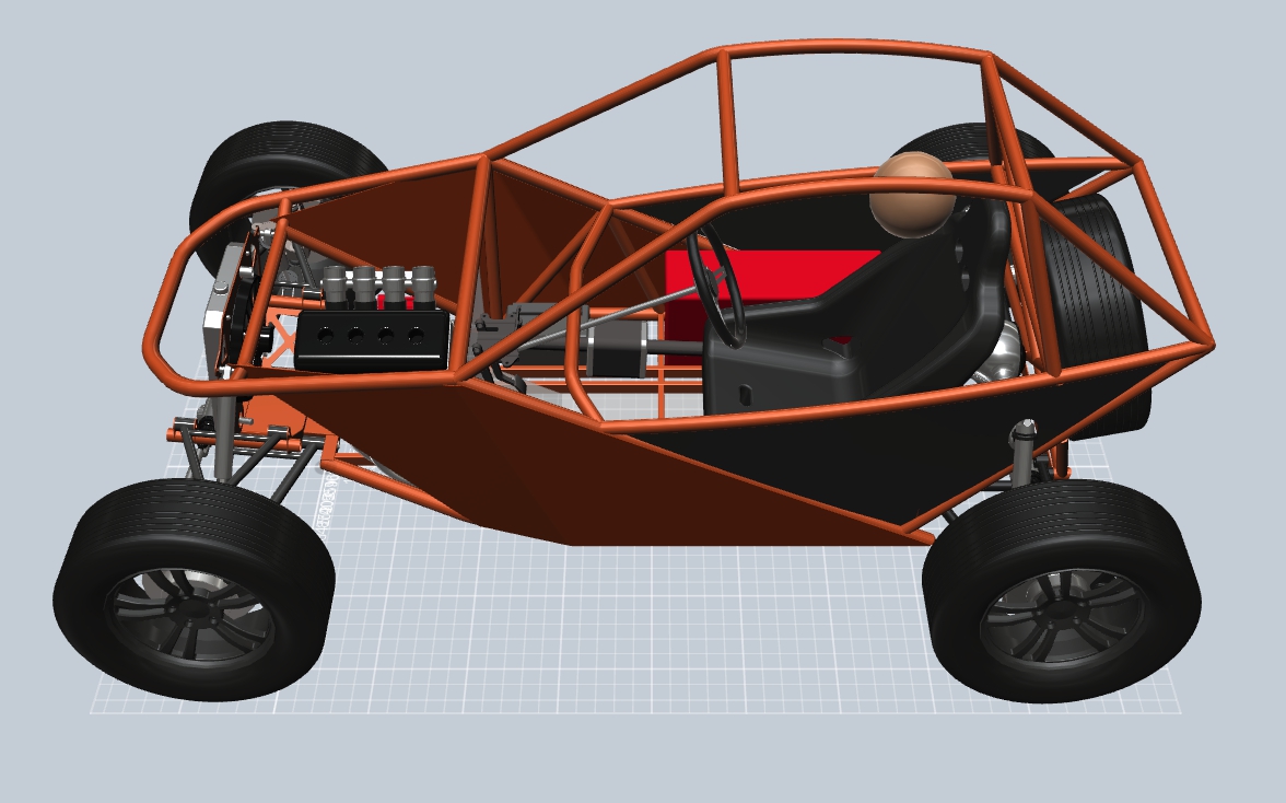

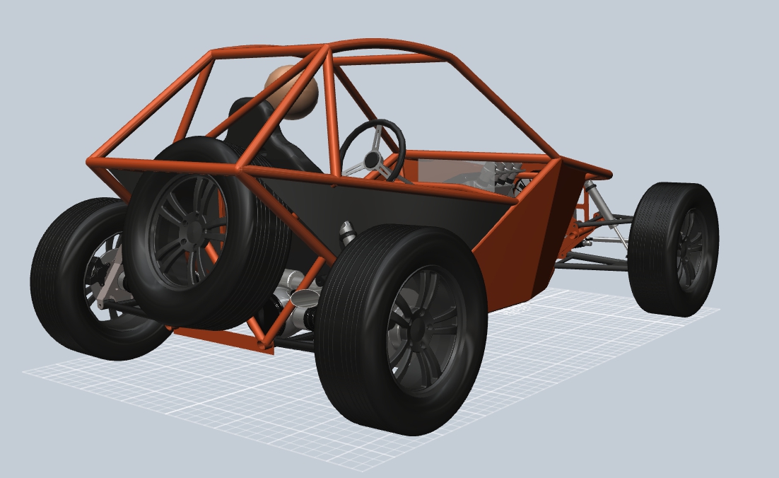

worked some more on the frame shape ;
(still missing a lot of parts)
high res; http://www.supermotors.net/getfile/1037002/original/spectre10.jpg
decided to go with large radius bends in the roof and rear side tubing
this allows me to get a lower (looking) roof ... kinda "coupe" style
high res; http://www.supermotors.net/getfile/1037003/original/spectre11.jpg
changed the exhaust to an oval muffler;
this way i can tuck it in lower next to the rear axle carrier ...
drops the CofG a minimal amount .... but every little bit counts :thumbup:
high res; http://www.supermotors.net/getfile/1037004/original/spectre12.jpg
instead of the previous more traditional frame with the added rollcage of the Austin concept i use bigger diameter tubing this time (but a lot less cross-bracing)
and arrange everything to form large triangles with the roll cage as an integral part of the structure.
to brake the body up into different looking panels i`m thinking to use a little trick;
the burnt orange panels are on top of the tubing (with the edges wrapped partially over the tubing)
the graphite panels are set in between the tubing.

Looks like you need to tie in the lower front tubes?
Looks cool, I hope you can stick with it.
R
RoosterBooster
Apr 24, 2014
225
Vegas (winter) ...somewhere in the Utah mountains
Sounds good.
yes, its still only a rough drawing
i need to tie in the front clip better and also work on the WJ cut plates that tie in the rear suspension points and diff carrier
btw here is how i plan to build the rear uprights;
high res; http://www.supermotors.net/getfile/1037036/original/spectre13.jpg
high res; http://www.supermotors.net/getfile/1037037/original/spectre14.jpg
again, a boxed structure made of fairly thin WJ cut plate.
found a brake disc that has the correct offset so that i can mount the light 2-piston DL calipers direct to ears on the outside plate.
lower H-arm will be fairly large diameter tubing to deal with the torsional load of the I&H-arm suspension.
front is a fixed PU bushing with the rear a "screw in" PU rod end to adjust toe
upper I-arm will be aluminum tubing with one forged aluminum Heim and one PU bushing rod end to adjust chamber.
i do like to use at least one PU bushing per arm;
it keeps things "quiet" (not like "metal to metal contact" Heim joints)
and i like the little "give" under extreme loads (takes away peak loads)
i just noticed that i may dont need to "lean in" the upper upright pivot point;
i did that for the narrow body Austin7S project to move the upper frame point closer to the body .... i probably dont need that on the wider body anymore :headscrat
would make the upright a lot simpler to fabricate ;)

"i just noticed that i may dont need to "lean in" the upper upright pivot point;
would make the upright a lot simpler to fabricate"
I was going to ask about that...until I read this, Ha.

yeah... thats the problem when you take over existing drawings & details
sometimes you did things for a reason that is not relevant for the next project :rolleyes:
anyway, i fixed the upright to straight sides and dont see a clearance problem;
high res; http://www.supermotors.net/getfile/1037045/original/spectre15.jpg
now the upright is stupid simple to build (sides can be made of strips of 1.5" flat stock)

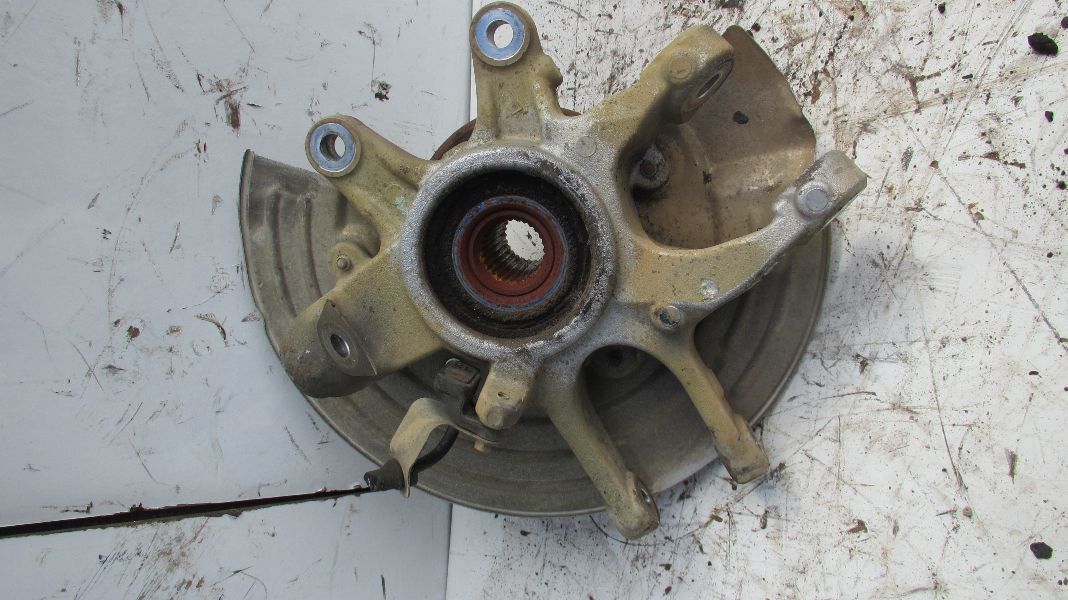

Just a thought but would Mazda Miata or MX5 be a good source of parts?
, the front and rear subframes are nice and easy to remove and narrowing them would be a lot easier than figuring out mounting points
Bigplum
yes and no ;)
small and fairly light donor uprights would be interesting,
but the Locost and kitcar crowd wants them as well, so its hard to find them parts in a local pic-a-part yard
on the other hand there is no market for used 2002+ explorer front axles,
so they are easy & cheap to find
the rear upright is now so simple to fabricate that i gave up on the idea to look for an already made donor,
or mill them out of aluminum
the hollow steel box shape will be just as light as a solid block of aluminum
the front spindle is basically the same story ;
donor spindles usually dont have the geometry and/or the mounting points that i prefer.
by using Heim joints it is importand to me that the mounting points are double shear
milling that out of a solid block of aluminum is difficult & expensive,
so again the boxed hollow steel plate construction is kinda the most attractive DIY solution.
i do want to have the suspension and uprights kinda overbuild to take a fair amount of abuse
(compared to a "street only" rig) ...
however, not desert racing kinda abuse :eyecrazy:
i`m more of a Rally kinda guy ....
so when i talk about off-road you have to think "Ken Block" not "BJ Baldwin" :p

... a "light" variation of the I- and H-arm IRS that i used on several other projects already.
i got it already drawn with all the pivot points established
Have you modeled that setup in a suspension kinematics program? If you have not, I have a WinGeo license and wouldn't mind inputting numbers to get you camber curves, etc. If you care about that kind of thing. (If you are building your own cars/buggies from scratch, I would assume that you would/should care).
sac02
May 15, 2011
446
I would use Heim Joints or thread rod ends for the inboard pivot points for simple toe-in adjustments.
Rod-ends are popular for their simplicity, but they are absolutely a weak point, with all those stress risers in the threads. I have seen several fail, not good.
For A-arms I strongly recommend a clevis at the end of the A-arms, with a shimable mount on the chassis/hub for strength/durability/light weight. It's a little easier to get away with/justify a rod-end on a toe link, because the loads are less, and the adjustments are more frequent.
Have you run the chassis through any sort of bending/torsion model? There are several "non-ideal" things going on in that chassis, from what I can see in the limited pics available. (Suspension pickups don't appear to be "nodes", bars attaching in the middle of straight runs of tubing, etc.)
I promise I'm not trying to **** on your project, lol. I think it's awesome - just trying to contribute and make it better!
R
RoosterBooster
Apr 24, 2014
225
sac02
for me there is absolutely no problem when you (or somebody else) is voicing his opinions :thumbup:
... especially when your right ;)
the chassis is just a "visual" raw sketch right now.
i did not really have the time to go into details like supporting any node correctly etc.
"unfortunately" i will head out for a 2 week roadtrip to Colorado today ...
no computer/internet :wtf:
so there will be no progress on the drawings for two weeks :lol_hitti

i had also some ideas for the uprights/knuckles
instead of re-inventing the wheel (aka fabing them myself) i probably also just dip into the OEM parts bin
there are several aluminum uprights that would be interesting,
like for example the T-bird irs knuckles;
or the Lincoln LS ones;
or the Mazda RX7 ones;
the RX7 would be a direct fit (but a little hard to find)
the others would require that i turn down the RX8 wheel hubs a little to fit
(RX8 hub OD is 1.7716, LS & T-bird bearing ID is 1.653")
but thats easy compared to building an upright from scratch :p
i guess i just need to make up my mind on what spindle to use
(each has it pros and cons on how the control arms and links are shaped & mounted)

guess the single seater idea is death :sad:
i actually gave up going the "super lightweight" direction anyway,
when i decided to make this thing "dual purpose" (street & mild offroad)
my target is now to make this a better "barbie jeep" ...er... UTV :p
looking at the RZR 1000 EPS Desert Edition ...
http://www.polaris.com/en-us/rzr-side-by-side/rzr-xp-1000-eps-desert-edition/specs
... i was surprised at how much the RZR grew in size and weight (and height :eyecrazy:) over the older versions.
LxWxH is 123.5" x 64" x 76" with a WB of 90"
estimated dry weight of 1651lbs
:wtf:
so "only" a 1000 cc/110 hp engine does not sound overly exiting to me :dunno:
re-drawing my concept to two seats and the transverse mounted FJR 1300/ ZG 1400 engine
i came up with the following dimensions;
LxWxH of 112" x 70" x 50" (in street trim with "only" 7.5" ground clearance)
WB would be 84" ... and i`m shooting for ~1200 lbs
engine output would be 145 hp and 99 ft-lb
for comparison i may add the 2014 Mini Cooper specs;
LxWxH is 146.6" x 66.3" x 54.4" and 98.2" WB
published curb weight is 2535 lbs
engine is a 1600 cc I-4 with 121 hp and 114 ft-lb torque
:beer:
