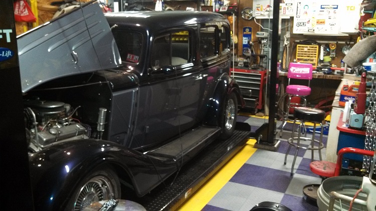

I had RaceDeck, but it was a major pain to clean under. Now I have epoxy in both garages...couldn't be happier.
Yeah, I think most will agree it's hard to beat the look of the RD tiles; however, this too was one of my concerns. I won't pretend I'm Mr. Mechanic but when I unleash my (amateur) wrench turning "skills", fluids will be spilled!
It bothers me fluid can leak beneath the floor. Granted you can pop the tiles out and clean, but seriously, who wants to do that on a frequent basis?
Just curious what epoxy did you go with, and why....and any cons to it?

Below is a picture from another forum. The owner of this Racedeck floor created a portable/collapsable cardboard work area for when he worked with fluids under his 4-post lift. Pretty good idea even if you don't have a RD floor.

Thanks for clarifying this. I am glad to see you guys use PP material. 100% PP is icing on the cake.
I know some other brands utilize PVC material, but from my stint in the business, I have a hard time getting excited about it. PVC was always the cheapest and poorest quality material mainly due to its inability to do well with UV exposure. While my garage does not see frequent long term sun, it's just not something I would want to deal with.
While on the topic of raw materials, am I correct to assume you guys purchase colored PP resin chips? So basically the color is integral to the product once the chips get melted down and formed during the manufacturing process? It might be interesting to see your plant in operation.
Lastly, are there any good answers on how leak proof the seams are with your solid tiles? Not sure an ASTM method exists, but in my head I envision testing that would involve an installed floor system and different chemicals (with different thicknesses and consistencies) being intentionally spilled on the tile seams and then observed to see how well the joints hold up and how long it takes for the chemicals to leak through the joints? I think most guys will be rather quick to clean up a mess as long as they know it's present. What might be problematic is something like a hose busting loose and leaking fluid while a vehicle is stored. If it leaks like a sieve, maybe something could be developed to help the tiles seal better and provide better protection to underlying floors?
This has always been my hesitation with Racedeck. Ideally, I'd like to be able to wash my cars in the garage. I don't want to have a bunch of stagnant grimy water festering beneath the tiles.
Cruisinthe34
May 22, 2013
27
West Virginia
I have spilled antifreeze on my floor and I have a pesky power steering fluid lead (I park a car on my lift daily). I have not pulled a tile to check underneath, but I have also used a power washer to clean my floor. There are 'channels' built into the underside of the tiles and with a properly sloped floor I have no worries about fluid setting under the tiles.
I am simply stating my personal feelings after installing and working with these tiles.

When we built our shop back in 2001, we got a bunch of epoxy floor coating, unfortunately, we didn't wait long enough for the concrete to fully cure, and as the moisture came out of the concrete, it blistered the coating and most of it came off. So we learned the hard way on that one.
When we poured additional concrete a few years later, we taped a square of plastic to the floor, about 12" square, and when there was no more water beads, then it was ok to coat the floor. That batch of epoxy worked great, and it's had lots of forklift traffic, heavy equipment, vehicles, welding, oil, hydraulic oil, etc on it with no issues.
I like the epoxy for cleanup of oils: spread on some floor dry, and sweep it with a broom.
I haven't tried any of the other mats, so I won't make any opinions on them.
