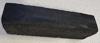

-There seems to be plenty of jaw caps available in brass, plastic, rubber, aluminum, and fiber. Where have you looked?
Apparently not in the right places (google, ebay, amazon)... :dunno:they all appear to have magnets incorporated into them. Was hoping for something like this old Protecto:

I have a bunch of different ones by Lisle; they all do have a weak stick-on magnet strip on the top edge, but I'm sure that could just be removed with a scraper if it's an issue.
These?
The nice thing about the Protectos is that they slip onto the existing jaws. There's a lip around the edge of them that hold them in place. These Lisles don't have that lip (that's why they have the magnets...).
Is there NOTHING like the Protectos available anymore? Hard to believe if true.
