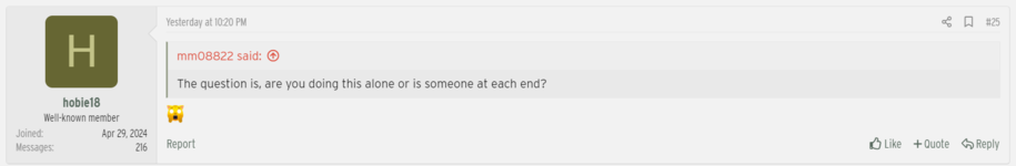

1729254198625.pngI'll clarify so it remains within the context of this thread.......
The question to the OP is.... Are you pulling the conductors by yourself or is there help available to feed the conductors into the conduit while someone is on the other end pulling simultaneously?
Sorry I missed this question. There will be help, one at each end. Wife will be feeding the wire and I will be pulling the rope.
