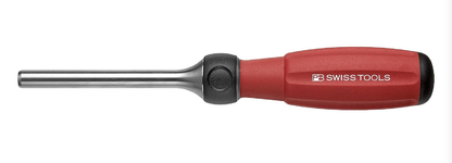

I have been my rethinking the screwdriver situation. I was admiring the PB Swiss screw drivers the other day, but it looks like they do not sell any square drive screw drivers. I'm not sure I have looked much at Vessel, I will look at them tonight. I will also see if anyone close sells them so I can check them out in person.

These are my Vessel screwdrivers (in my tool bag) there is also a P B Swiss ratcheting bit driver in there somewhere
