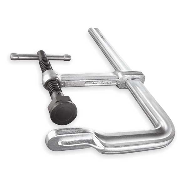

My go to clamp is the strong hand sliding bar clamp. I've got about two dozen. I love em.
If I need really strong clamping force, I switch to c clamps. New, I like Wilton and Armstrong. Used, I'm a fan of Williams, Grand Tank, and Billings.
Repeatable, one handed clamping I use 11SP vise grips.

I have used the Bessy type bar clamps, they are ok but wouldn't trade common ones for them. A guy might have a kant or 2 if he was repairing damaged steel.
