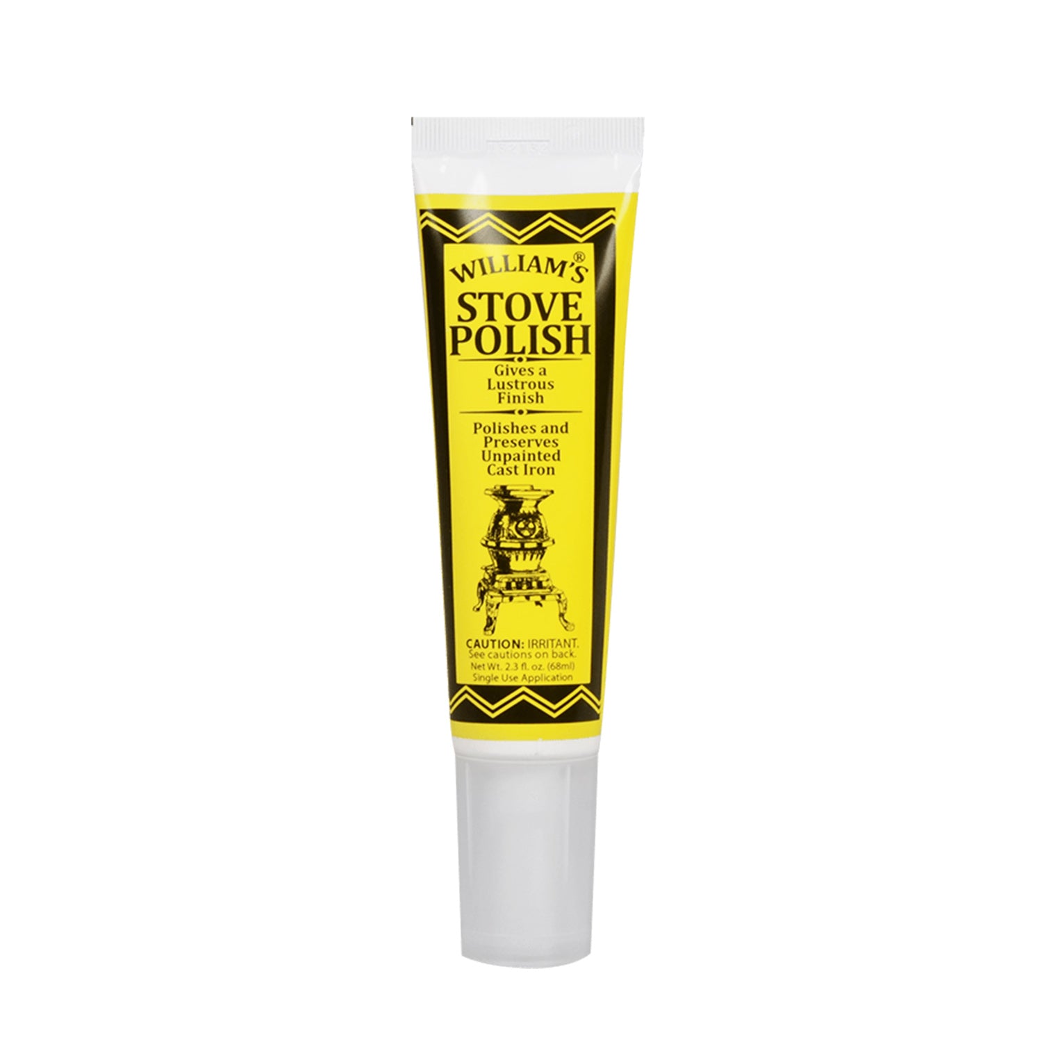

You'd probably have better luck with graphite stove polish, comes in a tube like toothpaste:
Is that factory paint on everything? It looks more graphite than flat black in the pic.
