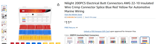

Hello everyone
I am looking to splice two wires using a **** connectors (which will be covered by a heat-shrinking tube as recommended). I am completely new at this so i watched some youtube videos and bought the tools already to start practicing.
Anyway, I wanted to ask for confirmation on two things and please refer to below pic:
1. When crimping a wire and a **** connector, should only the stripped wire part be inside the the metal barrel (ie. Green wire in the pic) or should a bit of insulated part be inside it too (Red wire in the pic)? If it's latter, should I try to get the insulated part also crimped?
2. My **** connector has a separate in the middle of it. Could you please confirm two wires (one from each side) don't have to be touching each other or the separator?
I believe the answers are keeping the insulated part wires inside the metal barrel and that two wires don't have to be touching the separator or each other. Any confirmations would be great lol.

All the crimp connectors I have used have the crimp on the wire only. The insulation is stripped back so there's only wire in the metal barrel part. If the crimps are solid the wires don't need to touch. Having a wall between the two sides means you can jam each side in as far as it will go and not worry about going too far with the first wire and not leaving enough space for the second wire.

Insulation should NOT enter the barrel (section where it is crimped)
Stripped wire length should allow for full depth of wire with a small gap (if any!) at the edge of the barrel.
What voltage, and where will this be used?

If you put the insulated wire in the metal part you're loosing the metal on metal contact. The wires don't have to touch and usually can't because they're separated. That's what the metal part is for.
What are you using this on?

If it's in a dry environment and the wire you're splicing is #10 or smaller, insulated crimps are the easy way out. (T&B 2RC10 for #10 and 12, 2RB14 for 14 and 16, 2RA18 for #18 and 20)

Thanks everyone!
The voltage is 12V and it's actually for my parent's car. I watched a How-To video on youtube but wasn't getting any responses for weeks so I decided to come here out of desperation, and i hope that's ok.
As for tools I bought for this job, followings are the ones. I believe my two wires looks to be AWG 16:
1. Crimping tool for insulated eletrical connectors AWG 22 - 10 (I will be using the Red mark)
2. **** connectors that has a metal barrel with a separator in its middle (I will be using the Red **** connector)
3. Wire stripper (I think i can use the crimping section in this wire stripper but decided to buy a #1 crimper as recommended)

What wire on your parents car?
Those cheap terminals **** IMHO. The plastic is stuff and breaks down.

Those bits and pieces should work fine on a 12V **** splice.
But what wire, and especially what circuit, are you splicing? Good crimps will be fine on almost any 12V circuit, but when I've removed previous-owner car alarms on two Tacomas now, I've soldered the main ignition circuit wire when I've rejoined the ends cut for the alarm.
A **** splice probably woulda been fine -- I've done LOTS of them -- but for a critical circuit that doesn't see any strain behind the intrument panel, I feel better with a soldered connection.
Hi PCustoms,
Do you have a suggestion on which brand have good terminals/connectors by any chance? I found those on Amazon and they all have a good review and look the same.
I thought about using a heat-shrinking **** connector but i worry that may be damaged over time because the wires i will be splicing are right near the engine.
PCustoms
Jul 23, 2011
23,684
VT
Hi PCustoms,
Tyco
What car? Why are you having to crimp in a new high pressure fuel pump adapter?
And lastly, do your parents know what you're doing?

They sell waterproof connectors that will shrink with heat after crimping. I'd get those instead of trying to use heatshrink over cheaper connectors.

If your gonna put heat shrink on the connections anyways (I would) then ditch the insulated crimp connectors and use non-insulated ones. If you already have the plastic insulated ones, it's pretty easy to cut the pvc insulation off of them and just use the barrel from inside of it.
Get some heat shrink with adhesive in it, it's often advertised as waterproof.
Alternatively, you can get the 'crimp and shrink' style **** connectors. They work fine but just don't look quite as clean.
As far as the crimp, all good info above. Insulation stops at the barrel.
