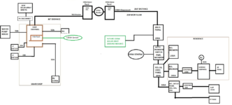

Question for the legit Sparkies (I am not one).
A friend asked me a question about his duplex which is under construction in Florida (prior was destroyed during hurricane). He owns both units (lives in one, rents adjacent unit).
There is a SINGLE 400A service which serves both units; owner did not want to pay the separate meter few to have a meter on each unit. There is a shared laundry room, and the 200A main breaker panels for each unit are located there. The configuration is shown below in the graphic I made after talking with him this morning (hopefully its clear). I don't know if there are ground rods or a UFER.
Unit 1 (Owners residence) is fully backed up by an automatic generator to pick up all the loads in his residence. He would like to be able to run the mini-split and fridge in Unit 2 during loss of power events. The 200A main breaker panels are side by side with just a stud between them.
His electrician suggested installing a generator interlock with backfeed breaker at the Unit 2 panel (which is a sub panel), a piece of conduit with ******* between the panels, and a matching size breaker in the Unit 1 panel. I do not know the proposed breaker sizes nor the loads of the minisplit and the fridge.
As far as we know, the disconnect at Unit 2 only breaks L1 and L2 which we believe is same for the Generac ATS. The N-G bonds occur at the disconnect and in the ATS, with a common G at the meter can. Generator is 4-wire feed with separate N&G.
So - is his electrician's approach sound?
  • On Loss of Offsite Power, the ATS takes care of Unit 1 and separates it from the grid (L1 and L2 only to my knowledge).
  • Unit 2 is black on loss of offsite power. The disconnect is still enabled (pass thru). The owner would then rack off all of the breakers in Unit 2, flip the Unit 2 interlock taking it off the grid, enable the back feed breaker, then enable only its AC and fridge breakers.
  • Although the N-G bonds occur in two separate devices (disconnect and the ATS), electrically the seem to be the same to my untrained mind via the common G at the meter can.
Being the non-sparkie that I am, I suggested he just put Unit 2's AC, fridge, and maybe a main lighting circuit in the Unit 1 panel with appropriate labels and then he would not have to intervene (perhaps put the Unit 2 breakers at bottom of panel while keeping the Unit 1 breakers at the top of the panel). I expressed concern that an untrained user might try and rack too much load on in Unit 2 and what if no one is home at either unit? He would also need to undo this when power is restored which would not be needed if the cherry picked Unit 2 loads where put in the Unit 1 panel.
Thanks for your help.

If I follow, in "practicality" it would make senseto put an interlock on sub-panel #2 and a feed breaker from unit #1 (generator backup) associated with that interlock. That makes sense to me. Is that NEC legal? I have no ******** idea. But the idea seems right.
How is power paid for? I wouldn't want my neighbor AC load on my panel.
With modern power monitoring, you can monitor total power use and get actual use per unit for under $150 via a wifi device. One time fee.
Can you move stuff over to panel 1? The answer to that is typically via "load calculation" and my guess is if these are moderate condos and both have full 200A that the math will work when on grid power.
But it begs the question: Can the generator handle the load from both units? Because that's going to be a thing. A 20KW generator is only about 80A service feed. Two ACs starting at the same time may sink that generator. I have my ACs on "delay start" so that doesn't happen.

The only issue is the grey matter safety. In other words, you 'have to know' how to do this or you can do this wrong and send power back to the grid.
( interestingly enough if you didn't open the unit #2 main you would put power on the grid which would do two things at once, choke the generator with potentially massive load and shut down the generator when it senses 'street' power on the top of the ATS so it might be a self correcting problem ).
It is all well and good if nothing ever goes wrong and no one ever makes a mistake.
I believe the suggestion above by dcg9381 about moving the critical loads to the unit one panel is the simplest and safest.

I disagree. The whole point of an interlock is that it's idiot proof, you cannot do it wrong. You are physically prevented from backfeeding. You can't reverse the electron streams.
The ATS handles the rest of it, it's either grid or generator.
If you can backfeed or loop it, better bet it's not NEC legal.
Maybe you mean the sparkie could do it wrong.. that's possible.

No, if you look at what he wants to do, he doesn't mention changing the main disconnect, he mentions turning off breakers. The 'interlock' is not on the main, but in a breaker on the panel proper.
Now, if he was putting in a transfer switch in lieu of the 200A disconnect, perhaps. But in that case, the expense of your method ( move a couple of circuits ) versus replace a 200A disconnect and install interlocking breakers, your method still comes out on top.
Perhaps I am misunderstanding what they are trying to do, but I can't imagine someone wasting all of that money and effort and making things manual and complicated and, since they have to decide how much load they may or may not want to add, not idiot proof.
Move a handful of circuits just seems more sensible.
There is an ATS upstream of the panel 1. That can't backfeed. So panel 2 is either fed by grid or it's fed by interlock panel 1.
Let me know if I have it wrong.
Depending the orientation and length of wires may make sense, I agree.
I'm baffled by the concept of 2 residences with one meter and no one seems to care..

I am not sure if you are right or not actually. How does one put in an interlock and leave the main disconnect?
In my view you either have to replace the disconnect with a transfer switch ( interrupt the grid ) or you have the potential of mixing the grid and the generator. Throw in manually doing anything and that leads to
As far as the 2 residences one meter - options are the home owner is cheap, home owner is illegally renting the space out, home owner is including utilities in the rental, home owner is avoiding the 'house' panel ( third meter to provide for common area services ), all of the residents are members of the same family, home owner is providing shelter to the needy in the most efficient way possible. Humanity no longer baffles me sadly.

@eejack here is a typical generator interlock. Note how it’s either or - main breaker or the generator back feed. The presence of the disconnect is irrelevant other than it being where neutral and ground are bonded.
Both panels are main breaker panels as shown in the sketch. These act as disconnects in the panel.
The interlock is in the sub-panel. This assumes there is a "main feed" in the subpanel - either a breaker or switch (in the sub panel) that gets thrown when the interlock gets switched. Not all sub-panels can accept interlocks. Without being able to lock out the grid, you don't have an interlock.
We agree that any configuration of "mixing" grid and generator by accident is a violation of code and also makes you an idiot.
Sure. It's just so darn easy these days to stick a power meter on one or both sides. I have this identical setup pretty much, only my main is 320A and + solar. I monitor total power use with an app..

This is all brand new construction.
The panels are main breaker panels as shown in the sketch.
I too questioned the single meter for two residences but that’s not relevant to the question. I don’t understand the why but just move on.
What if you had a single home, 400A service, 2 panels, only one of which was on a generator via an ATS but you wanted some loads on the other panel? Would you interlock it and self manage loads or just cherry pick circuits and move them to the generator panel?
What about the N-G question posed?
should work fine as long as the feeding breaker from unit 1's subpanel is interlocked with the 200a main breaker in unit 2's subpanel. he will need a 4-wire feed between the panels.

Unit 1 & 2 subpanels are main breaker panels, so an interlock on unit 2 panel will work just fine with #2 being fed by #1. The interlock forces the disconnection of the main breaker in #2.
Thank you. This is my conclusion as well.
The N-G bonding at the ATS and disconnect should still be kosher, correct?

The neutral and grounding would be fine assuming they are all bonded properly in the main service. This only works because there is only one service, only one meter.
Personally I would move the critical loads to one panel as it makes zero difference which panel a load is in. You mention they are a stud apart. Has to be cheaper that adding additional breakers/interlocks.

Yes Unit 2 sub-panel would have the interlock and back feed breaker. Unit 1 matching supply breaker could be on all time I’m thinking (back feed breaker at Unit 2 sub panel controls). This covers L1 and L2.
Why would he need to tie the N an G bars between Panels 1 and 2 via a 4-wire feed? This is the question I have been struggling with. They are all still bonded at the ATS and Disconnect via the common G to the meter can? It is easy to do if needed.

I have this configuration (below). What I did to solve it was put an interlock on panel 2 and a generator inlet. Panel 1 and generator are "automatic" and stuff just works. Panel 2, you have to walk down, flip the interlock, and fire up a 10KW generator by hand.
If this is a "vacation home" and we don't want food to go bad, I'd do it differently, I'd move the circuits over to the panel that is ATS protected.
not true with interlocked breakers.
with an interlock on the subpanel #2 main and the subpanel #1 feeding breaker, it would be impossible to have both closed at the same time.
how does one make a mistake with interlocked breakers? only one breaker can be closed at a time.
it seems you dont understand what an interlock is
no actually thats more complicated than just installing an interlock. no need to move branch circuit wiring between panels

the 200a main disconnect that is just after the meter has no bearing on the interlocked main disconnect in the subpanel and the subpanel #1 feeding breaker in subpanel #2.
wrong again. the main disconnect in subpanel #2 and the #1 subpanel feeding breaker in subpanel #2 are interlocked. this means that subpanel #2 either gets power from the grid via the main disconnect above it or from subpanel #1 and the generator. theres no possibility here for the grid and the generator to be feeding subpanel #2 at the same time.

Some new information.
The automatic transfer switch for Unit 1 duplex 200A sub panel, is a Generac RXSW200A3. This is a Service Rated automatic transfer switch and serves as the main disconnect for Unit 1.
Here is an excerpt from the transfer switch manual. L1 and L2 from the meter can connect to terminals N1 and N2. The manual makes references to jumpers A and B, but "B" is not depicted; I can't explain this. The manual is quite clear to connect the generator's neutral to the lower neutral lug and never remove the jumper wire (described as B but shown as A) which connects the upper and lower bars.
Because Jumper A remains in place, I believe the neutrals and grounds are all connected together here in this device. I had previously used the term "bond" for this junction (and my black dot in my graphic) so I hope I have used the term properly.
The generator wiring is 4-wire feed from the generator, connected to the transfer switch per the manual, and at the generator the N&G are separate.
I am still waiting on details for the Unit 2 disconnect. I believe it to be a service rated disconnect. I have to believe it is only breaking L1 and L2 with an internal lug/bar where the utility neutral lands and then the 4-wire feed from the Unit 2 main breaker subpanel has the N&G connected to the utility neutral. Unit 2 200A main breaker sub panel then has separate N&G bars.
I BELIEVE THE SERVICE AND MAIN PANELS ARE LIKE THIS. This example is a prior home I was involved with. 400A service, two 200A sub panels, only one of the 200A panels backed up by a generator via the ATS. This picture was taken before the feeders to the sub panels were run and before the power company tied in the meter can. The ground wire shown in the left panel (ATS) going thru the conduct is connected to the UFER ground in the home. You can see the green jumper "A" is in position bonding (I hope right use of term) the neutral and ground.
I will circle back when I get more details. My friend is supposed to be on site next week and he will remove the panel covers and take pictures of what he has, verify device part numbers, etc.

ok so the ATS is the disconnect for unit 1 and there is no disconnect ahead of it?
it doesnt look like it switches the neutral.
The N-G question is still an issue. When the tie breaker from panel 1 is closed and the interlocked cb in panel 2 is closed (& main cb open), the neutral current required for panel 2 will split into 3 paths:
  • Neutral Path 1 - from path #2's nuetral up into the 200a disconnect enclosure's neutral, into the meter, and back into the transfer switch's neutral bar.
  • Neutral Path 2 through the neutral of the tie breaker wiring between panel #1 and panel #2.
  • Ground Path 3 - neutral path 1 current will further split at disconnect #2's bonding screw, through the enclosure/conduit ******* and recombine at the xfer switch's bonded neutral bar. (This would create a shock hazard.)
This is the same situation as created in this thread: https://www.garagejournal.com/forum...outlets-two-main-panels.528743/#post-10548412
Best way to have accomplished this (having only one meter) would have been to use a single 400a ATS immediately after meter. There would be only one bonding screw and it would be in the xfer sw.
An ATS with a switched neutral would still not work b/c of the 2 bonding screws in seperate locations.

  • Neutral Path 1 - these conductors I assume are sized properly for 200A during normal grid power. The back feed breakers I assume would be at most 50A, and the generator output breaker is at most 100A. Wouldn't this mean this path is adequate?
  • Neutral Path 2 - This 4-wire conductor would be sized to the assumed back feed breaker of 50A. The N&G in this conductor would connect N1 to N2 and G1 to G2 (ie - jumper the bars together). Wouldn't this mean that this path is also adequate?
  • Ground Path 3 - You got me here at the shock hazard statement. Although I don't fully understand the why, I think this is the deal breaker.
I will update with more details next week when my friend is on site. I don't expect things will change from this point. I will advise him that the best option at this point is to cherry pick the Unit 2 loads and put them in the Unit 1 panel, only after confirming the generator has adequate head room. If necessary, he can load shed some loads making the Unit 2 loads sacrificial.

  • Neutral Path 1 - these conductors I assume are sized properly for 200A during normal grid power. The back feed breakers I assume would be at most 50A, and the generator output breaker is at most 100A. Wouldn't this mean this path is adequate? (1)
  • Neutral Path 2 - This 4-wire conductor would be sized to the assumed back feed breaker of 50A. The N&G in this conductor would connect N1 to N2 and G1 to G2 (ie - jumper the bars together). Wouldn't this mean that this path is also adequate? (2)
  • Ground Path 3 - You got me here at the shock hazard statement. Although I don't fully understand the why, I think this is the deal breaker. (3)
1. Assuming conductors are sized per cb rating, overload is a non-issue. The problem is this current path is not a singular current path run with the transfer circuit conductors. Code requires all ccc of a circuit to be in same cable/conduit, etc.
2. Assuming conductors are sized per transfer circuit cb rating, this neutral path is the correct path. The problem is, neutral current splits off of the intended path due to #1 above.
3. This is the bigger safety problem.......current traveling on the enclosure, conduit surfaces. With current flow, there is a voltage gradient created and can provide a shock hazard if a person were to touch these parts and another grounded item at a different potential. If the bonding screws in disc 1, meter pan and ats didn't exist, the problem would be eliminated. Problem is they are needed when the grid is running.

yes the neutral current flow is an issue especially since the ATS isnt switching the neutral and you have another pathway thru panel #2 disconnect.
