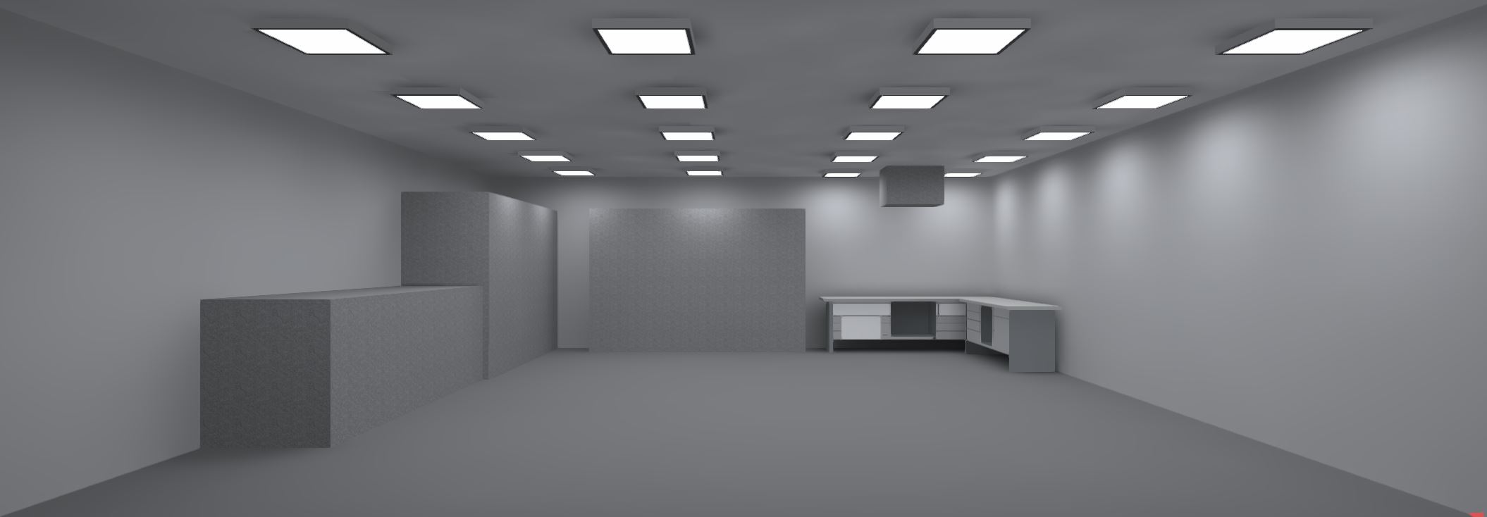

In response to this post by smalltown in another thread:
Platonic the only difference now is that I took your suggestion, and relocated the storage unit that was on the right hand side. It is now on the rear left wall. Let me draw something simple and post it with a photograph.
Here is the modified hand drawing with the implement storage rack removed, and showing the storage rack moved to the rear left.
I included 3 photos to show as it stands. Messy but getting there slowly.
Because of my ceiling heater the original 4 light you suggested will not be flush mounted. I will hang them down from something. I would like to install cabinets over my workbench "L" shape in the rear right corner.
I do like the Maxlite ...4803 fixture they appear to be a good quality from what has been posted.
What I would do today is quite different from my recommendation over 2 years ago.
Qty. 20 - 2ft x 2ft Flat panel LED - 40 Watt - Dimmable - DLC 4.0 Premium - 5,000 Lumens - LumeGen
$38 ea. (link) x 20 = $760
Qty. 20 - Surface Mounting Kit = $20 ea. (link)
$20 x 20 = $400
Total = $1160
Dialux PDF Report (link). See page 2 for mounting dimensions.
S
smalltown
Jul 9, 2015
985
Western Maine
Platonic Thanks your the best !
I must admit that I was expecting a fast ball, and a knuckleball went passed.
Looking at the surface mount kit I would need to drill them out to feed them with them my EMT conduit. I also wonder about future replacements if any panels should fail.
Platonic Solid
Nov 29, 2014
3,587
CT-USA
Yes, you will need to drill them for EMT. I would use 7/8" diameter Greenlee punch.
I expect LED edge lit panels to be around for quite a while. Finding replacements in the future should be easy. You would only be replacing the LED panel, the surface mounting box is universal.

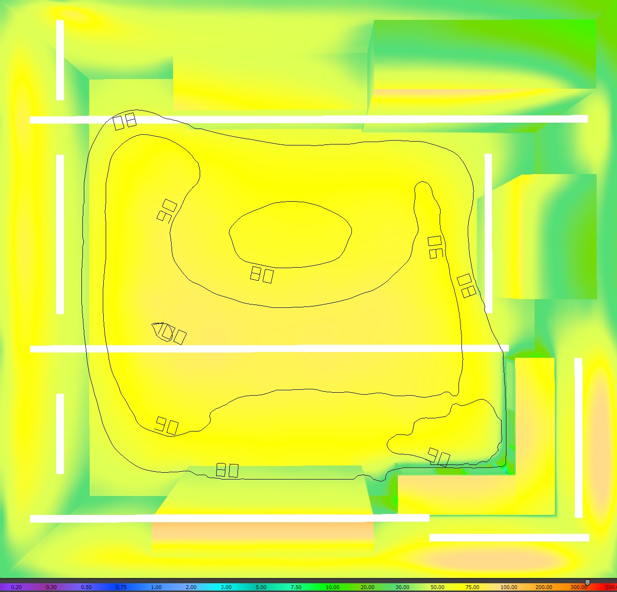

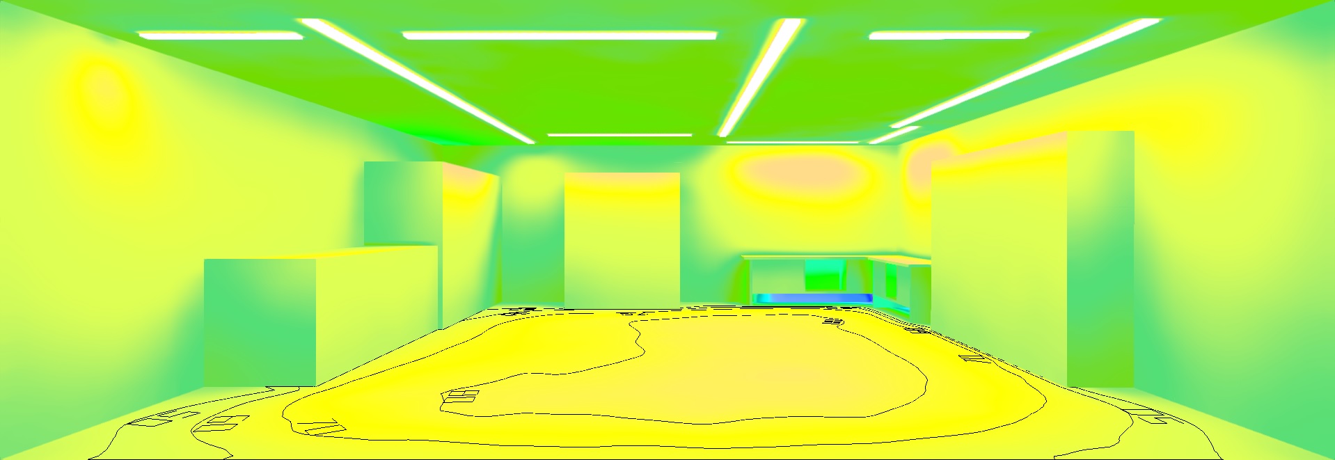

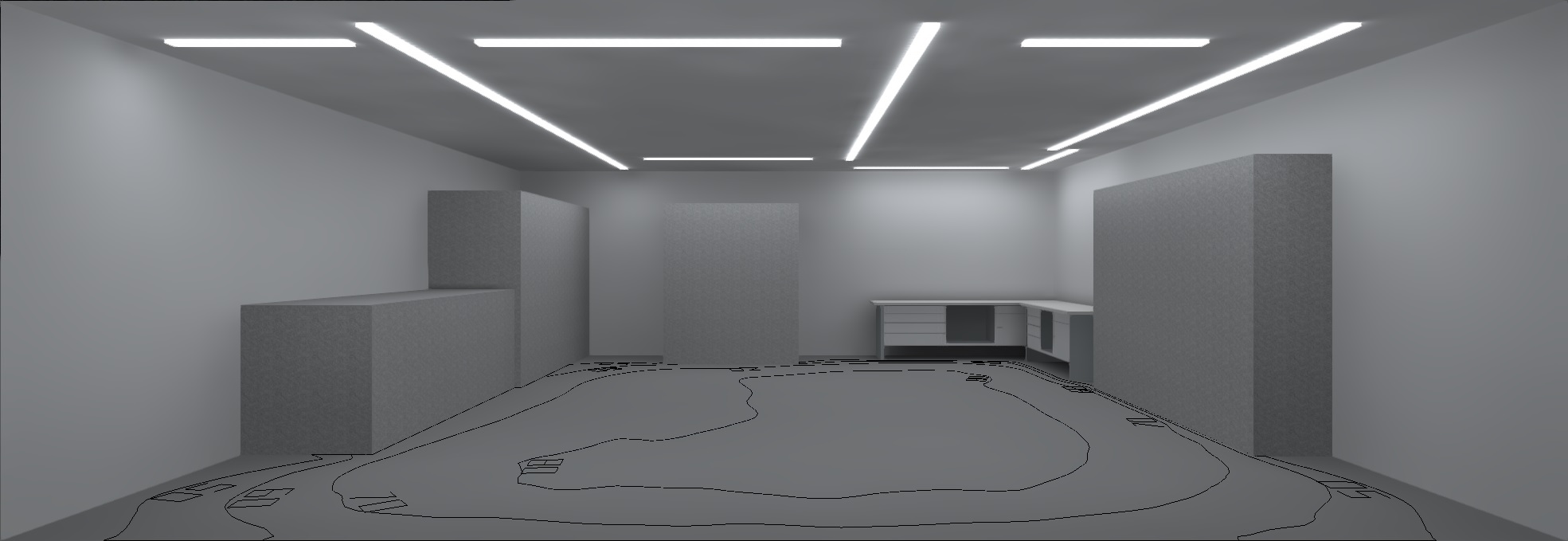

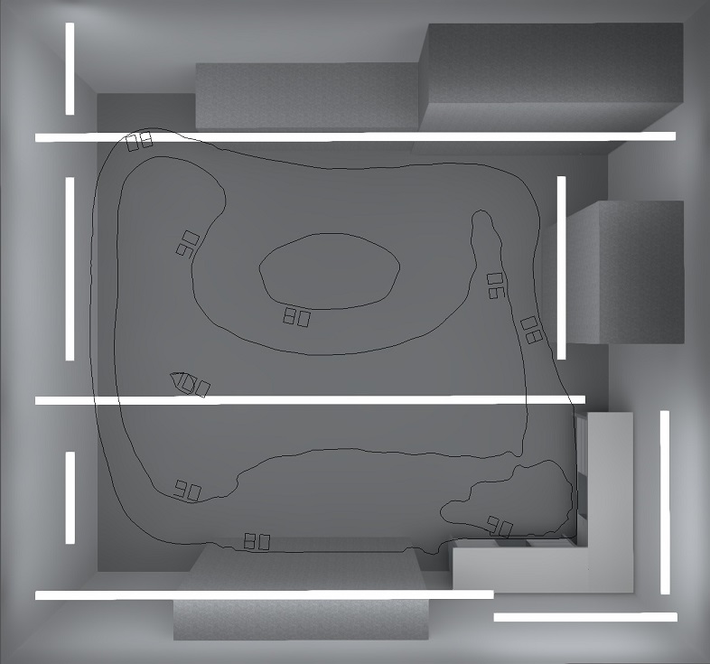

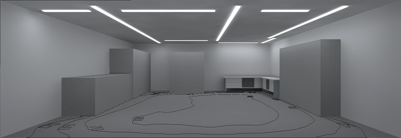

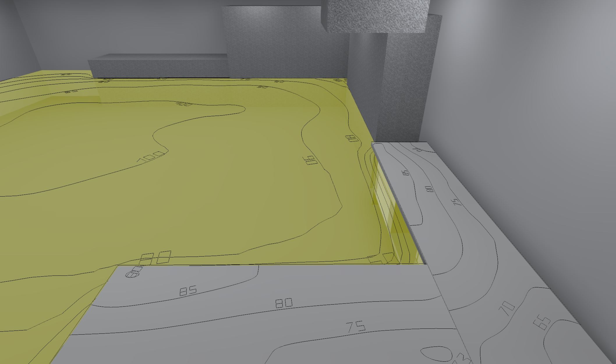

Platonic sometime please take a look at this. I have been trying to teach myself how to use the Dialux 7.1 software. Tried to upload the .evo, but it exceeds the allowable upload size.
Do you think this might work as no lights will be blocked when a vehicle is in the garage bay ? I couldn't figure yet how to draw the hanging heater. Maybe I should eliminate the 2x4 light over the work bench, and try two of the 2x2 on either side of the heater over the workbench. Couldn't figure how to get the second 2x2 luminary when I have the 2x4 in the program.
These light are the LumeGen 2x4 9000Lm
P.S. I come around to liking the Epanels, and intend on wiring up a dimmer.
Platonic Solid
Nov 29, 2014
3,587
CT-USA
I assume you did the math and understand that 12 2x4 fixtures with surface mounting kits (total 108,000 Lm) will cost $100 more than 20 2x2 fixtures with surface mounting kits (total 100,000 Lm).
Light Loss Factor for LEDs should be changed to 0.90.
I would push the first horizontal row of 2x4s closer to the wall or the vehicle will block those lights.

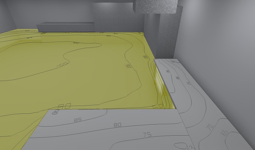

S
smalltown
Jul 9, 2015
985
Western Maine
Platonic thanks the Light loss factor made a big difference.
I tried moving the first row closer to the outside wall. The simulation seems to show a lot of reflection when the edge of the light fixture is 2 feet from the wall. At what point should I be concerned about reflection ?
What surprised me about the 2x2 lay out was there is less square feet of fixture on the ceiling. 80 Sq. " for the 2x2, and 96 Sq.' with the 2x4. But won't a vehicle block more light in the 2x2 layout ?
Platonic Solid
Nov 29, 2014
3,587
CT-USA
Trying to reduce glare from reflected wall light yet getting light between the car and the wall is a balancing act. Getting light between the car and the wall is more important than glare reduction from reflected light. You can try to keep the reflected wall light hot spots near to highest workplane result.
Regarding vehicles blocking light: Put some cars in there and check the results.

Platonic could you be of any help ? I have tried searching the catalogs to download the 2x2 similar to the Lumgen. So far I have only found one, but it did not have the option for 5000Lm
S
smalltown
Jul 9, 2015
985
Western Maine
Platonic thanks.
Platonic yes I had already downloaded that, and when I tried to place it in my project it showed up as round. I'll try again.
Platonic Solid
Nov 29, 2014
3,587
CT-USA
Lithonia's IES files can sometimes be very questionable. I've had to fix many errors in them. You really need to get a better graphics card so you can run V7.1 as it permits you to fix some IES flaws. You are getting into an area that requires more technical experience than I'm willing to get into.
