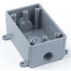

My wife and I are doing all the electrical in our new garage and bedroom addition, aside from the new panel, and I have a question on the wall boxes I have for my 50amp outlets. I wanted some extra room for wiring up the 6-2 romex so I went with a plastic 2 gang box. After I got back home and started installing things I noticed The knockouts were too small for the wiring so I cut a hole in the side and installed a wire clamp. When the electrician I hired came to upgrade our service and install my new sub panel said he had never seen that done before and didn't know if the inspector would give me a hard time about it. I know I saw some 2 gang boxes at the store with plastic clamps already built in like this so I didn't think it would matter. Thoughts? I already have them installed and really don't want remove them unless I have to.

The clamp is installed backwards if it matters to your inspector

The inspector could say that the plastic box is not listed for this field modification.

^^^this. For the the first 5 years of my residential career we drilled out 1/2" holes in plastic cut in boxes and used them for island and meninsula plugs. We installed ent fittings and surf tube for sleeving. It was always kosher until they decided that it was a violation of listing. As that plastic box wasn't designed for drilling a hole. I think it's **** personally. They told us if it was meant to have holes in it then the manufacturer would put some in it. I call hog wash. Some steel and some Carlon pvc boxes don't have any kos in them, are we not suppose to make our own in those?
And I would agree with the inspector. Use a 4X4 or 4 11/16 square box with a 2 gang ring mounted to a block

Get the 2 and 1/8 " deep box though with 1/2" plaster ring shown on bottom pic. Use 5/8 " ring even better . . Just be sure ring will be flush with finished wall surface. Be sure box is secured well. jmo

^^^^ This. You want a metal box anyway in my opinion. This is a setup where you have to push and pull with decent force on the plug. If the plastic threads strip out you get to start over and do it again. The metal box forces you to put a more serious wood block behind it, not the cheap nails. Nothing irritates me more than spongy electrical boxes.
Home Depot around here seems to have a big advantage over Lowes in this department, they have a full lineup of Raco 4" dished covers. In other words, the receptacle mounts to the ring, the ring is screwed into the diagonal corners of the box. The ring is trim and structural, all at the same time.
Edit: check out Raco 810C.

Thanks for all the reply's guys. It seems like it really depends on the inspector so I'm just going to email him the pics to see if he has issues with it before I go ahead and replace it, since it's already installed. My wife has talked to him a few times now and he's been very helpful. I chose plastic boxes simply because I will be washing cars inside often and it just seemed to make more sense, no other reason.
It is a 50amp (6-50R) that is going there but I also have (2) 30 amp outlets going in as well and just held it up for a picture reference. It will be used for EV charging as I work on new Tesla's occasionally and the owners appreciate a full charge when they pick up their cars.
I dont know how you couldnt fit the wire in with the clamps in box. You could cut the tab between the two and put it that way,but the wire usually will fit in the single spot
That was an option too but as noted above that would technically be modifying the plastic box, no? The metal clamp idea was a suggestion from a friend who used to be an electrician after I mentioned seeing these Carlon boxes, which are essentially doing the same thing.

Unless fixing it will cause a big disruption, I personally would not reach out and ask. Seems like you are welcoming the failure that might not have been issued otherwise. That said, i would use a metal box too.

Thanks! It will be a few weeks before the inspection and I still need to run wire for all the overhead lights so I may just take your (and the others above) advice and swap them out for metal boxes.

If you do decide to stay with the plastic box and it breaks, be prepared for a thousand "We told you to switch to a metal box" messages.

The grounding conductor in 6/2, and 6/3 NM is 10 AWG, run a little extra cable into the metal box and wrap the 10 gauge bare conductor around a ground screw, no need for splices & a quick and easy way to bond the box. 12 AWG is not acceptable for a grounding pigtail above 20 amperes.
