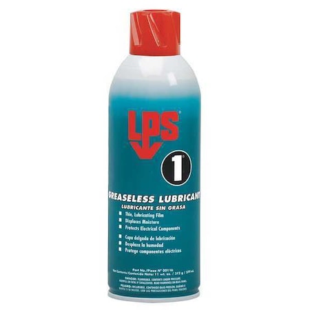

As I have learned from Garage Journal, there are many paths to your destination.
Evaporust has its place, but before you go that route, just try cleaning them up first.
I'd try something like LPS1 and a clean rag.

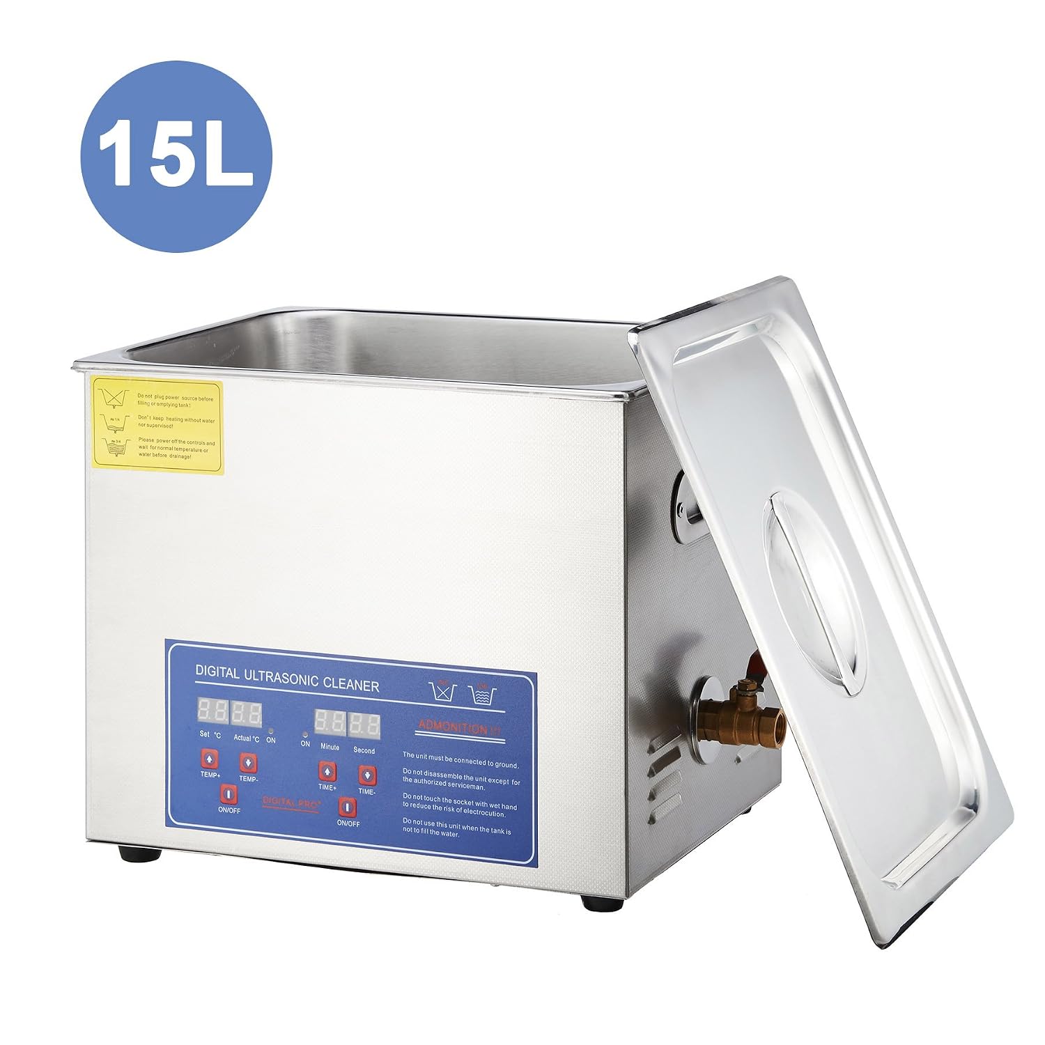

If you don't mind spending a little money, but yourself an ultrasonic cleaner - one that is heated. You can get them on amazon and ebay. Yeah, they are made in China, but for the value - tough to beat. 10L or 15L is a good starting point that wont break the bank. This one is where I'd start: https://www.amazon.com/Tek-Motion-Stainless-Ultrasonic-Jewelry/dp/B01HBDUM74
it has a 10% off coupon today!
I use a 50/50 mix or Simple Green and water and plonk the tools in there for about 20 minutes. Dry them off and if you like the way they look, spritz them with LPS1 or similar to displace the moisture and let 'em sit for a day - you can then wipe off the excess oil.
If you have a ratchet, I would not go this way unless disassembled. I'd hate to get water inside a good rat.
