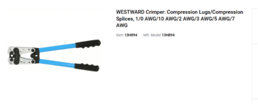

Battery cable crimpers and lugs for bolt on terminals, or crimp on battery cable ends.
But your going to find the newer the car the more specialize the cable/ends are including built in battery sensors, bult in fuses etc.
For those you are usually going to the dealer to buy cable/harness assemblies, I did one on a 2020 Honda today.

As far as replacing battery cables suggest using crimp style terminals and hydraulic crimper with appropriate sized dies.
