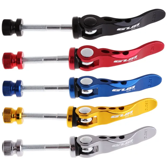

This should be quick and easy for her to use and have the ability to adjust tension. They are common on bike seat posts so I'm sure you can either find one that fits or adapt one to your application. Oh and get a shiny anodized one to add some bling to the sled.
MTB-Road-Bicycle-Seatposts-Clamps-Quick-Release-Axle-Skewers-Seat-Binder-Set-SS.jpg_640x640.jpg
4xdog
Aug 18, 2012
5,666
Santa Fe, NM
^ That's what I'd do, too.
And as a cyclist for the last forty five years, I have more than a few of those around here...
