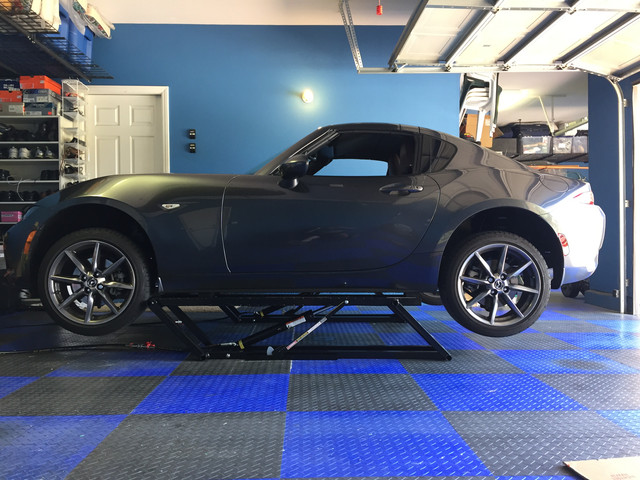

midorix
Jun 27, 2012
169
Love my QuickJack BL-7000SLX. Clearance not an issue even on my lowered Miata. Using slotted QuickJack blocks and hockey puck. I often see Costco now carries these and put them on sale at times.
