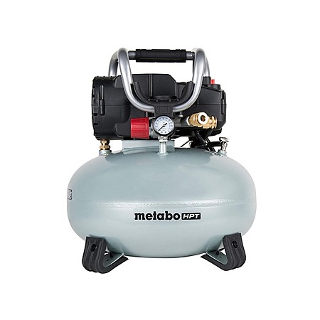

Citation
Jan 20, 2016
3,261
Indy
Metabo pancake compressor that claims to be reasonably quiet.
I've never bought from Woot but this might be a decent option. It claims 73db. CAT will claim 60db for most of their 1hp models. My phone app says my "60db" CAT is more like 70. Well, if this one is honest it might be a good option. a 6 gal, 150 psi pancake tank would be a lot of air compared to most of the above options. Flow rate at 90 psi is low (2.8 cfm) but not drastically so. It has 2 outputs.
