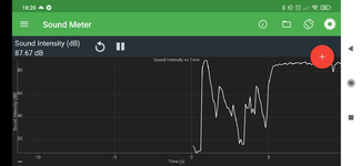

After looking at Helmholtz designs and pondering the long avenue of tuning and still not getting all the other frequencies and harmonics, I decided on a brute force approach. Convoluted cambers. This resulted in a ~8.3dB reduction and is not unpleasant to be working 8ft away when its running. I was worried about restriction but the cycle times seem about the same. Inside the bottom cavities of the silencer are "tree" supports from teh print which probably help a bit more with the reduction. The filter is just a standard lawnmower filter which is the same one that was on teh compressor for comparison.
Much of the tingy tack tack tack tack, that's left seems like noise that is from teh output and resonating in the tank. This gives me an idea of an output muffler between the tank and compressor now!
Sound measurements were taken with phone and compressor in identical, unmoved locations.
Tree supports in lower cavities.
Before
After
That's an interesting result. I think that is the same pump on my compressor. I got about the same 8db reduction when I switched from an open filter (basically just as loud as no filter) to using the current CH filter + about 1.5' of vinyl tubing that just fits over the snout of the air intake. This isn't the exact filter I have it is basically the same design.
https://www.amazon.com/Element-VH90...MP333200SJ/dp/B09LLWR93X?tag=atomicindus08-20
That filter + $2 worth of tubing worked really well.
