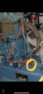

I have a 1970's Quincy 208 Rev 5 compressor. Seems to work fine except when it cycles off I hear a very slight hiss coming from the air intake. It is enough to cause the system to cycle after about an hour.
Any tips on direction to take in order to get the right parts to fix this?
RacerX
Mar 27, 2007
377
Caldwell, Tx
Sounds like the one way valve at the tank is leaking, pushing back to the compressor and that's what you're hearing.
Time for a new one way valve. Or you might get away with taking it apart and cleaning it. Might have something in it blocking it open slightly. Be sure and drain your tank first.

The quincy pumps use the output valves as the tank check valve, typically. So the output valves may be a bit leaky.

It is a 208. She said there were 4 suction valves and 4 discharge valves and they were $80 each. Not knowing exactly what she was talking about I just took her word for it...looking at the pump now I'm assuming there are 4 total.
She said I could just replace 4 springs and 4 disks...so that leads me to believe it's 4 total valves (2 suction and 2 discharge).
I'm going for the disk and spring replacement as it's cheap enough and probably not too difficult.
If I go with a one-way valve on the tank...does it get mounted somewhere on this pipe?

You would have to remove that fitting from the tank and install the in tank check valve and then connect the line back to it.
Also before ordering your springs and disks you might want to check the condition of your valve seats and make sure their in good shape and make sure their flat and true because if their not then new disks won’t help cause they still won’t seal

Great advice Tony. I'll pull them out tonight before I order them. Never took apart a compressor motor before but I'm assuming its the 4 big round luggy looking things on top that need to come off and be checked.

The valves in hand should hold liquid a few seconds.If they hold fluid and not clapped thin they are most likely still good.
Pic of top,head.Over-view.Manual below in link.
https://www.revbase.com/tt/sl.ashx?...204648&fileID=1189332&AdminID=1302&z=770f6bb8
Pic of air inlet to tank.I bet there is a 1 way valve already.Its possible you don’t have an unloader?
Pictures are a 1k words.
Or there’s nothing wrong with it at all.????
Spin it over by hand when you shut it off,does it unload.? Hiss?
