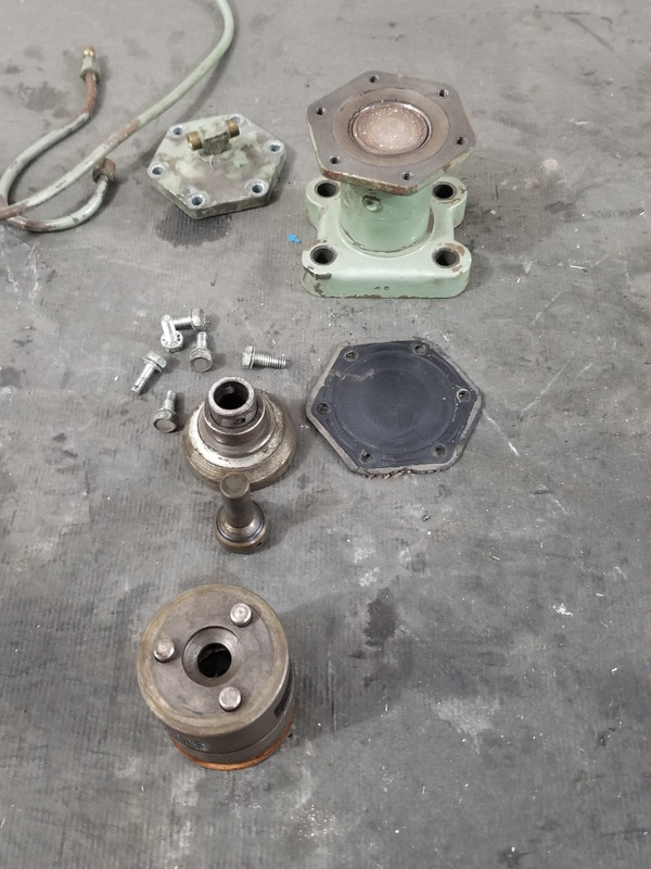

Ok so here is one of the intake valves taken apart. To me they look fine, everything is loose and the diaphragm is not torn? That being said I'm extremely new to compressors.

That’s the unloaded tower which does have the valve inside. You still need to remove one more bolt to access actual valve. They sometimes don’t seal fully and need to be cleaned or replaced as needed so no air leaks through. The valve plate is pressed against body with a spring.
You sometimes can flip valve plate over to extend lift. I’ve also sanded mating surfaces with 500 then 1000 grit paper on glass plate to ensure air tight seal.

C4, the issue won't be found in the unloader tower. It should be isolated in the discharge valve that is located at the exhaust port that feeds the receiver. Is this a single or 2 stage pump?
The part shown in the bottom of your pic is the intake valve. The discharge valve is similar in appearance.
Look at your parts download for the discharge valve.

So do I need to remove the head to get at this?

Thanks guys I got it, pulled the discharge valves out, sanded flat, and now it seals. I learnt a lot about my compressor in the process.
