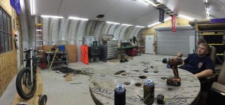

Update! Starting to move in.
I don't know how to correct the photos being upside down. They are correct on my phone.

So this is my idea of a day or two...
Plans are below along with pics of the parts. I keep saying I'm gonna start it. But I think I have analysis paralysis.

Well had to rearrange a few pieces. Decided to move my expansion tank to the larger board. And the put my thermometers in line going both directions. Finally added a male and female plug to the end of my pipe so I have somewhere to eventually plumb in my hydro solar project. That's a separate thread. First gotta get this running.
Oh and "installed" this little fan today. I use the word lightly because all I did was take it out of the box and set it on the wood stove. It does a really nice job. It was a Christmas gift and one of my favorite this year. d74008f08b0883bc5c9df8b3a3eaf557.jpg
Here are the latest. Only thing left on the check list:
> vent the water heater. I had a 4" hole saw bald but it's dull and will not cut the hardened steel the hut is made out of.
> plumb the propane. I have the line already ran from my (2) 450 gal house pigs, all 3' underground.
> wire my pump, controller and thermostat
> pump my 50/50 antifreeze/water mix into the floor and tank
Sent from my bag phone
