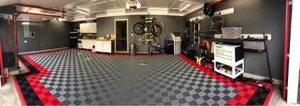

Ok I got the floor finished up on Tuesday and thought I’d post a few pictures. I still have a bit of clean up and organizing by the Cayman and my Porsche decor back up. So far I’m really loving the Flow Through as opposed to the solid surface RD I had before.

That looks great :thumbup: Is the center grey the "Alloy" color, or "Graphite"? I am assuming Alloy. Just submitted for a quote yesterday and plan to use a grey as my main color as well if I move forward, just not sure which yet. Thanks!

Yes alloy. The Grey I worried would bring the floor up and make it feel too cloister phobic with the dark gray walls.

How hard is it to cut the tiles? I am trying to decide between these tiles to the roll out mats.

It’s really easy. I started out using a circular saw but, like the Diamond Plate RaceDeck I had before, it cuts easy with a good box knife. It can get pretty tough on your hand after I while but I just split up the cutting across two days. The saw was fast but man it makes a mess! And with the Flow Through tile not being solid surface, the teeth would bang into the tile fins and would break the tiles if cutting close to the edge. Just use a good straight edge and a box knife. If I were doing these a lot or professionally, I would have a jig and a some type of guillotine. I also tried using my angle grinder with a cut off wheel and it just got way to hot and was just too fine. It would just melt and ball up.

CooperS - Race Deck floor looks great!
And I have to ask about your ceiling. It has a coffered look - can you tell me about it? Maybe an additional pic? I've got places in my garage ceiling where the drywall tape is starting to lift and peel. Your pics gave me an idea - use 1x pine boards to cover the seams with a coffered look. If I primed and painted the boards before install it would be an easier fix than drywall taping and sanding above my head.

That is EXACTLY what I did. The builder didn’t finish the garage drywall, just poorly taped the ceiling and none on the walls. As far as the ceiling, I got quotes to finish it ($1000) and no way was I paying that price to just finish the ceiling. And no way was I doing it! I hate drywall work! But I was standing there one day and it hit me, just use nice clear pine 1x4 to cover the joints and nail lines, then caulk and paint. I ended up with 4x4 areas across the ceiling.
It’s more paneled than coffered. I added 11 4’ LED twin tube lights and ended up with $400 in the whole project DIY. I’m not super happy with the pegboard anymore so I’m thinking of ideas to change it. The ceiling looks different over the Cayman because the truss run the opposite direction but it works out ok. [emoji16]
