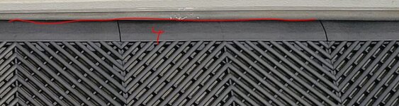

I like the trim idea.. I glued and screwed some pine into the concrete stem wall to create a ledge and left enough room for the tiles to fit underneath it. Same applies to the garage door rail. I also included a pic of where I cut the tiles along the wall... I think I only "wasted" about 20% of the tile along that wall, so not as bad. Still felt kind of bad though :p

Looks like you used edging pieces to bridge the gap to the wall? Any zoomed out shots? Going that route would reduce the need to get a table saw and measuring and cutting.
here ya go
