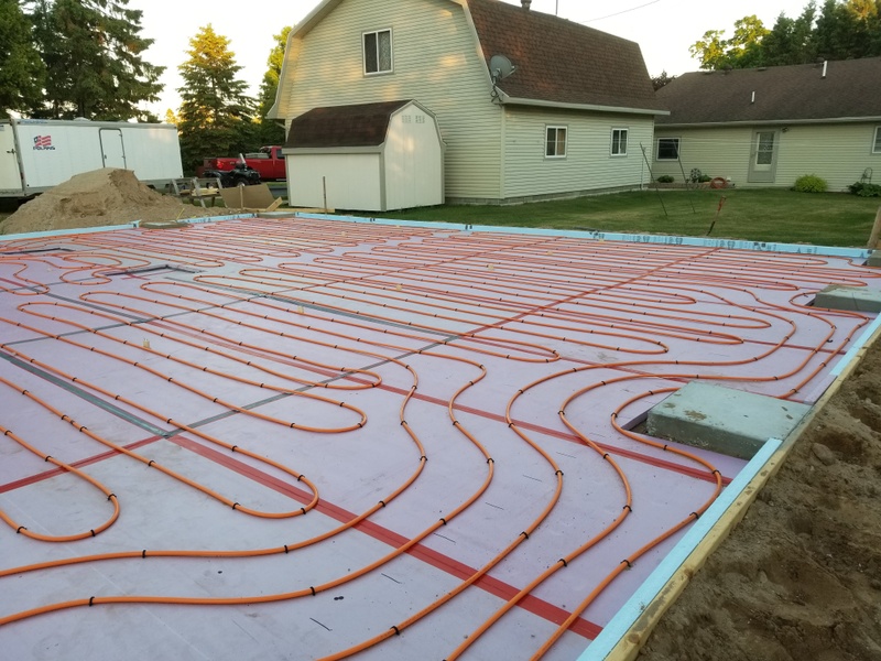

Anyone have a suggestion on where to buy radiant floor supplies
Dow 2in blue foam and pex tubing for a large project.
Trying to get a rough idea for a price on radiant floor insultion
And tubing

I put radiant heat in a 40 x 70 slab last summer and got all my supplies from Menards. I used 1/2" PEX and broke it up into multiple circuits to keep the runs the proper length and to separate some rooms so they could be kept at different temperatures. Two inch rigid foam was used under and around the slab. An excellent source of information is Radiantec.

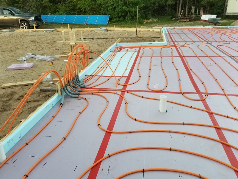

You can use 1/2” pex for the floor still. Length limit is 250’ on 1/2 so one loop should be to the end of the building and back. Spacing for 1/2” should be 8-12” depend on insulation levels of the walls/ceiling. If you layout you tubing carefully and keep each loop exactly the same length you can save significant money as you won’t need manifold with balancing valves on each loop. A building that size I would place 2 or 3 separate manifold spaced out for the loops to come back to.
Use the expanding propex system with pex A oxygen barrier tubing. It doesn’t restrict flow like crimp fittings, is more leak proof and if linked a heat gun can work it out unlike pex b or c which has to be spliced.

I did my own garage and I have to echo a lot of firebrick’s feelings. First this is a big building and little mistakes in Your heating system could cost you a lot over the life of the building very seriously consider getting a professional for this even if you just do the installation yourself.
If you are going at it yourself definitely get the book modern hydronic heating it is pretty much the Bible of heating systems. An additional resource is idronics on Caleffie’s webseite they also have several good YouTube videos many feature the writer of modern hydronic heating. I doubt you will be able to beat supply house on price for quality components. I would personally recommend pex-al-pex it lays nice the oxygen barrier is sandwiched in 2 layers of pex to keep it protected and the compression fittings on manifolds are easy. When you have your building finalized look up loop cad you can use it for a month for free it does an excellent job laying out your pipe and will help keep everything balanced just print off and save the files unless you want to pay a lot of money for it. Start searching now for a used stapler it will make life easier and after you are done you can sell it for what paid pretty easy.
