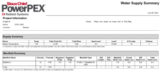

Getting ready to buy the pex for my new shop, ~3,000sf with ~3,300lf of tubing per the design from Menards. They also call for their SiouxChief brand of Pex B. After researching Pex types over the last few days I’m conflicted on if I go with the Pex B or upgrade to Pex A…looks like a roughly $1k difference in price, so not exactly chump change!
What’s the general consensus…is the Pex A worth the premium?

I have used Rehau Pex A with their fittings for many years.Pex A is superior in every way.Went to the Menards site and they don't list 1/2" Pex A at all.To be honest I wouldn't use Menard's to design a dog house.
Interesting! Maybe you'll see some obvious WTF thing with their design:
Doesn't appear that Menards designed it, Sioux Chief did or their software did. Very common to have the suppliers engineers of the products in lumber yards to do design work.
I would probably loose a loop and give some space to around the perimeter, and leave a spot for a lift in the future. I really don't see the need for exceeding the rule of thumb of 1' of tubing per square foot of floor. Unless your planning on poorly insulating it?
