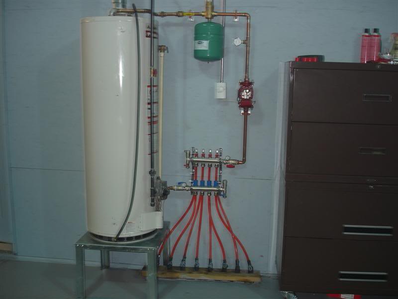

Using a water heater is often not recommended because they don't have large BTU inputs -- a typical standard 40g WH is only about 26k at 80% -- the fast recovery is 40k at 80%. This is not often enough for a house .. but may very well be enough for a garage. What you have to understand is if you are asking the unit to be running all the time it will not last as long -- water heaters are designed for intermittent firing -- and stay hot. they often condense when used in radiant heat.
Another factor to keep in mind is the speed of change -- the key with radiant success is maintaining a space temp and this is achieved with enough insulation. trying to quickly heat a slab requires hotter water and this is often not possible with a WH and a cold slab.

I did just what you are talking about, and it has been working great for 5 - 6 years now. I did have to replace the water heater for two reasons,
1) I started with a 10 year old water heater.
2) I had to go with a power vent because my garage was too tight for the first one to vent properly. (I have no windows, and very tight insulation)
