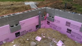

My shop is 40'x28' = 1120 square feet. 2" of insualtion cost right around $1 square foot ~ $1100 . 1000 feet of 1/2" pex tubing cost around $500 including the manifold for the 4 loops. I spent another $150 for 200' 3/4 pex to get hot water from my Baxi boiler in the house out to my manifold in my garage in 4" PVC underground. That supplies the cheap heat to the garage.
I used the same leftover pex tubing to run both hot and cold domestic water out to the shop in underground 4" PVC for my silcocks.
While I was doing the new garage I bought the Baxi boiler to do the house ~ $3500 installed in the house and plumbed to convert my whole house to radiant floor heat in the floor joists (1000 feet of 1/2" in 4 loops ~ $500) and did the new stained glass studio (250 feet of 1/2" pex ~ $200). 3 zones + gives me the domestic hot water.
I could not think of a cheaper or better way to heat everything. It is doing fine and is very efficient.

Moving along on the build, I need to get my **** together and figure out what I am going to do. I am pretty certain that I want to at least get the PEX in the floor, even if I don't use it for a while (or ever). The cost adder for the PEX is not that high.
Footer/wall is insulated, I need to make 16" pieces to fill over the ledge blocks. I also need to figure out how to do my thermal break at the overhead door openings. I have some ideas I am going to sketch up.
I need to make sure the concrete sub that my contractor is using is okay with everything.
I should probably start a thread in the gallery, but I have not much time right now, and that will just take more to keep the thread updated.
