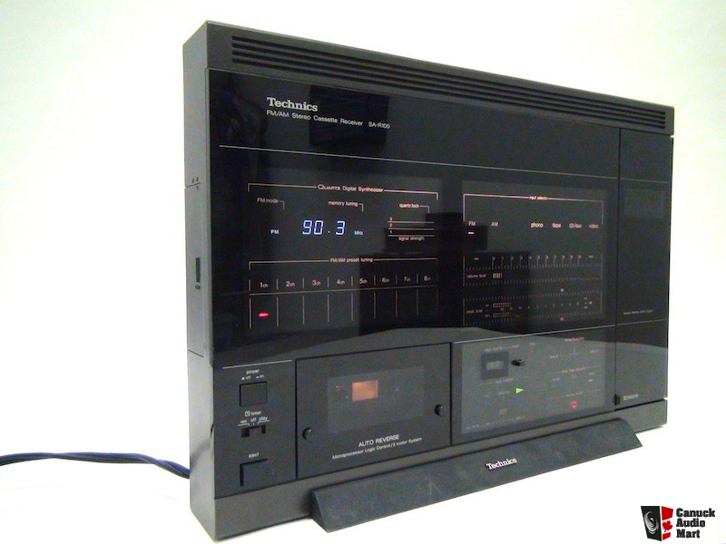

Technics made a SA R100 Wall Mount Receiver....

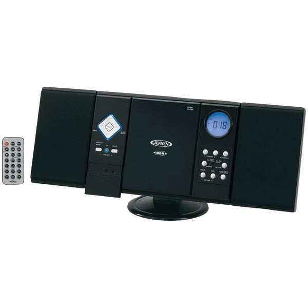

Today, Jensen makes a Wall Mountable CD System with Digital AM/FM Stereo Receiver and Remote Control
You can buy it at home depot for about $50.
For "in the wall" recievers, google RV stereos....
