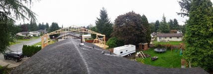

The new addition towers over the existing roof by approx 6'. With the scissored trusses, it gives me a maximum height inside my upper workshop of just over 11'.
Upstairs.
Here's a pano from the top of the roof.

So, in the shot of the trailer in the doorway, I noticed long 2x4's along the left wall that appeared to be bracing the upper floor. Are they, or are they merely leaning there?
And in the upper workshop, the area of the wall where it meets the attic of the house appears to be partially open. Are you going to open up a portion of that for storage room?
