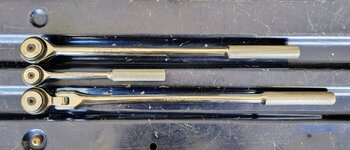

I’m resurrecting this thread for one reason — I need to do some maintenance on my Proto round head ratchets. The instructions call for Molykote LTW2 which is like a black high pressure grease from what I can gather. I can only find it in large cans. Does anyone know if SuperLube could be substituted? Or another grease? I love these ratchets and don’t want to screw them up.
Yeah man you can use superlube. If it were me, I'd try to remove as much as the old crease as I could, and then apply superlube.
Facom uses "grease with graphite", should be same mechanism as the Proto models:
Graphite was used as a lubricant in old school locksmithing and I use a product called lok shot which is the modern PTFE based equivalent. It's a bit thinner than the grease shown in the video but my Beta round head seems to like it. I did try silicone grease in the same ratchet which made it quieter but a little gummy and inconsistent.
Honestly though, I think it would be difficult to "screw up" a round head ratchet using the wrong lubricant as long as you have something in there and clean it periodically.
