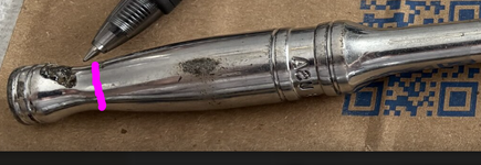

I want to fix the handle. It is sharp and needs to be filed down.
Has anyone filled a damaged ratchet? As found, but looks like someone contacted a battery terminal
Ideas I was considering before deciding to post a thread.
JB Weld, plastic dip, super glue with baking soda, silver solder, and convert to a hard handle. If hard handle convert, what is used to keep the handle in place. Other ideas?
Ratchet is from 1976 and other than the damage, the rest of the chrome is in great shape.

Hard handles are held with friction alone. Turning it down to the correct diameter would require a very good machinist. Unless you can do it yourself, it would cost more than a new ratchet. You can fill it with a steel filled epoxy like JB Weld and file it to the right contour if that is important to you, but it will be the wrong color. Silver solder runs like water when melted. Not to mention what the heat would do to the surrounding plating. So I think that would be an exercise in frustration. I don't know what tools you have available, but this is a perfect application for a bench grinder with soft wheel.

Its at the end of the handle so its not a structural problem. I think I'd fill it with JB Weld then abrasively shape it as close to the original shape as possible. Leave the jagged finish to help the epoxy bite into the steel. (don't smooth it first). If you play yoru cars right, you won't have to abrade the metal at all. Looks like that's all valleys, no mountains.

Grind smooth, scuff handle up., plastic dip several coats. If you have anything else to dip have it ready too. Pre clean with acetone. Once you pop the plastic dip can you have about 48 hours to use it.

Another vote for JB Weld. I used JB Weld to fill in a missing wooden insert in an old Ruko pocket knife. After sanding it down it turned out so nice that I did the same to the other side.

Favoring a hard handle conversion using tight hole and not machining the metal ratchet down.
Snap-On used tough steel and I do not own a lathe. Want to make this easy with my drill press, to opening up the plastic handle and press the ratchet on the handle.
Easy path, but not sure what glue or expoxy to use.

If you want to glue it, roughing the surface will be almost required. Any epoxy will do but epoxy strength is affected by cure time. The longer the cure, the stronger the bond. I try to use 24 hour epoxy for everything.
