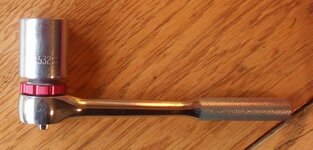

I have this set of adaptors like these for use on a ratcheting box wrench. Thumb wheel, low profile, O-ring wrench retention, detent ball, and QR all included! Thinner than most ratchet/adaptor combos.
