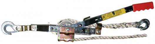

Maasdam A-20 Rope puller
The 20 refers to 20 foot rope, also available in other lengths. Ratchets both ways. Note that this is not a regular come-a-long as the rope does not wind up on a spool, it just goes around a sheave.

Right concept !
Just hoping to find it in strap without such a large handle.
The generic term is "web strap hoist". Big handle for big pull !

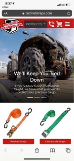

I was on the hunt for small straps for my ladder rack on the truck. I bought some endless loop straps from here. Super nice quality.
Interesting. I've never seen a come-a-long mechanism in a tie down strap though. I suppose this comes close.
The proper term is web strap ratchet hoist. They are frequently used by linemen for tightening wire.
Heavy duty, $$$ !
