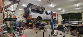

Getting Miller 375 plasma cutter modified for CNC automation by bringing trigger and output voltage out to a connector. The trigger aspect is simple, allow table controller to fire plasma machine by closing a contact.
The torch/work output voltage is used for torch height control, but needs to be divided by 50 for use by THC. Easy enough, 2 resistors.
Langmuir's THC kit came with a divider box. I opened it up to see how they did the voltage attenuation and 'filtering'. Didn't want to re-engineer a filter that is already done and tested so just used their box.
Attached box inside the unit so I didn't have to run high voltage (92V in my case) out small connector that is not rated, or have it spew noise into trigger circuit. THC divided output goes to bulkhead connector.
High voltage leads go to 'work+' and 'torch-'. Tapped into trigger leads (violet)
Whipped up a cable assembly to connect plasma to table.
Previously the air filter was attached to weld cart. I wanted to keep it with plasma machine instead of mounting to table, so attached to cover and plumbed it up. Added a valve on air inlet so I can unplug without blowing my ear drums, as the filter and hoses hold a fair amount of air volume. Else I need ear-pro.
Connected cutter to table. 220v power cord is long enough. Strung up torch lead. Installed fire control sw and moved head around to make sure wiring didn't impede movement, had to change a few things.
Next step is dedicated air system. Can't decide which of 3 options to go with.
- run hose under lift from existing drop on other post
- extend piping on ceiling almost all the way to other wall (north)
- continue main line on north wall and put in 2nd short ceiling pipe
I still have a 20' piece of 1/2 pipe, so just need to decide and do it. Not a blocking item as I can just use a hose on floor.
