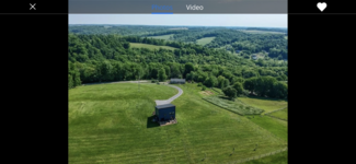

Plans look fantastic. I've been kicking an idea like this around, still working with the loft part, in my mind.
I noticed the overhead door into the garden area is 7ft tall and there is an area designated "Kubota". I dont know what Kubota but if it's a tractor be mindful of your ROPS as the one on my Kioti is near 8ft before I installed the canopy.
Very interested in this plan and build. Any pics of proposed build site you'd like to share?

I'll try to get some site pics this week. Width wise; the lot is 500' wide I think? It's almost a square, but nothing is flat in PA. So grading will be a bit of work, but the plan is no retaining walls or similar. My whole lot slopes from back down to the front. I bought this place last year planning a garage build. Previous owners built it in 2020, and leveled a spot on the opposite side of where I'm planning. It would work for me if I did a 24x36 or so there. And that's really the scenic view side from the house.

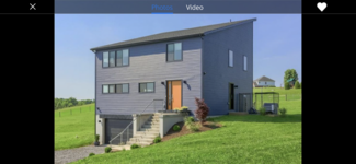

OP, do you have any photos of the house? From what I can see, it looks like a shed-roof? Definitely interesting.
Sure! Attached. The house was built on 5.5 acres in 2020. I bought it in 2022. I wanted a newer house with a big garage. I couldn't find that, so I found a newer house with enough property and rural zoning to build my own.
Awesome. I love the simple style, and your property looks very similar to mine. (y)

Style is very simple, and inside is very modern/european. I'm a simple guy, just wanted a big shop :)
And while the property may look similar, it is far from flat about 40 miles north of Pittsburgh. The excavator was good, and no retaining walls were needed (a requirement of mine back to "simple").
