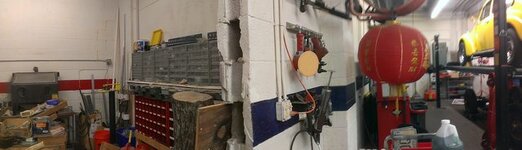

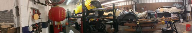

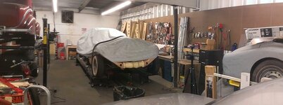

For the past two weeks, I've had the benefit of extra help in the shop, son-in-law Matthew and nephew CJ, so I have been able to get to some long-neglected jobs.
First, we added an additional fluorescent light to the main work bay. That will make it easier to work without a drop-light.
Next, we installed three exterior security lights. I had prepped them almost two years ago, but they go about 10 feet high and it takes two people to install them. The first one, cousin Daniel helped with (he helped with most of the interior lights), but he had to go back to school). CJ was the inside man and Matt climbed the ladder outside.
