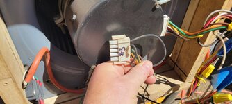

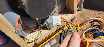

Finally got around to finishing up this project (and closing out this thread). Just in time too, as it's getting hot and humid here in NC.
I ended up mounting the blower on top of my torpedo heater so I can roll it around the shop. At that height, I can blow across my welding table or, by maneuvering it around, I can draw a decent suction in the vicinity of the table and exhaust it from the garage. I added a cage of sorts to keep squirrels, birds, and small children out of the squirrel cage, with a flat surface on top to accumulate more junk.
Because it's a ECM 2.3 variable-speed motor, I had to nuke out which of the pins on the 16-pin connector required 24 v power to get the highest speed. I also had to add a jumper to the 5-pin connector to allow me to run it on 120 v power, vice 240 v. Currently, it's just wired into an old extension cord so it's plugin/plugout control, but I may add a switch in the future.
Runs like a champ and much quieter than my pedestal fan.

I have this exact same motor and am trying to repurpose for my garage after getting a new AC installed in my house. I can’t figure out how to get 16-pin harness configured to get blower motor to run. Can you take a picture or describe better? Do you need a 24-V source to get it to run?

askhomerpr,
I attached the schematic from my air handler and some of my notes. What worked for me:
Thankfully, my HVAC guy told me to keep the wiring harnesses and plugs when I pulled the blowers out of the air handlers I replaced. Hopefully, you've got yours.
For the control power 16 pin connector, I picked up a 24 VAC transformer off amazon (you might be able to cannibalize one from your air handler). I wired up one leg of the transformer to supply power to pins 1, 3, and 15. I wired up the other leg to supply power to pins 9, 10, 12, 13, and 14.
For the main power 5 pin connector, I initially ran the blower with 240V power, however, I subsequently added a jumper to be able to run the blower off 120V instead, as I am able to use it in many more locations.
As I was looking at it again today, I'm speculating that there might be some other combinations that would work, but what I did works for my unit. I've got probably a couple hundred hours on it now and it works well. An advantage to this blower, as compared to a pedestal fan I have is it's much quieter. And it moves some air.
