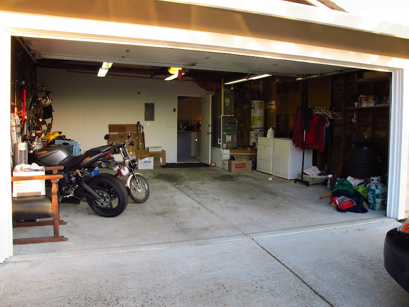

In summary my garage is ~21'x21' with a small area in the corner lost to the heater and water heater. One idea for reclaiming some of that space is to replace the old side-by-side washer and dryer with a stacked set and put them where the water heater lives now. Then I could mount a tank-less unit on the wall.
I've been going round and round trying to decide where to start and I think I finally have it. There is a gas line that is rather oddly routed through the garage that feeds the gas ignition for the fireplace in the house.
I think that the first order of business is probably to re-route this line in a cleaner fashion along the wall and higher up so that it will be hidden above the finished ceiling.

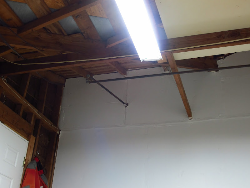

Here you can see the fist odd section of pipework.

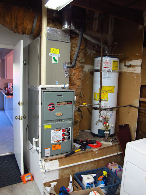

And the other end where it terminates into the wall.
Close up.

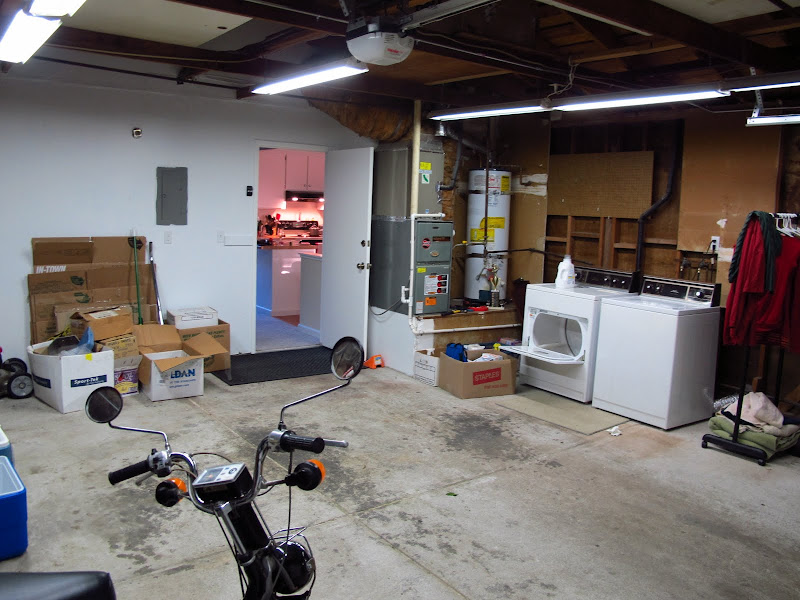

View from the driveway.

You dont need all those fancy tools for that job. you need a stret 90 a regular 90 a few ******* a union and a sawzall :D. I would shut the gas off at the meter . Turn the furnace or water heater up till it goes out . Then take the sawzall and cut the ****** between the 2 90's over near where it goes into the wall for the fireplace. Now remove all of the pipe back to the T over the waterheater/furnace . Once you have done that you need a street 90 that fits the existing pipe . Screw the street 90 into the T so that it ends up pointing up into the ceiling . From there you will need a long enough ****** to get you just over the rafters then a regular 90 . Then start running the pipe you already had back over towards the fireplace . Once you get back to that end you will need a couple more ******* and a union to put that end back together . Use Rectorseal #5 on all joints ( you cant use to much ) as you put it together . Once you have everything back together take a spray bottle and fill it with water and add a half dozen drops of dish washing liquid to it and shake it up . Then turn the gas back on and go through and clean the excess rectorseal off of your joints . Then spray each and every joint with the sprayer and watch for bubbles . You will be able to see if there is a leak as the solution in the sprayer will make bubbles if there is a leak . I dont mean little bubbles I mean it will look like the pipe is blowing a big bubble if there is a leak . No bubbles good go back and relight the water heater and furnace . Fireplace season is over so it is up to you if you want to relight the pilot on the fireplace now or in the fall. Should you see bubbles then you need to start over at the beginning and retighten your connections untill the solution doesnt bubble anymore . There wasnt that easy :D. I know you wanted to buy a bunch of fancy new toools but you really didnt need them for this job now did you :D.

I like your ideas! Definitely, lose the pedestal and place a stackable washer/dryer combo next to the water heater. Might even be a rebate there from PG&E. Reroute the gas line above the ceiling. As stated, very easy to do yourself and Lowes and HD carry threaded black pipe in various lengths. Thread tape and a soapy solution (to check for leaks) are your friends.
I would also suggest thinking about insulation. Yeah, we live in a very mild climate compared to the rest of the country but Dec-Feb gets mighty chilly here in the Bay Area. Most of my free time is spent in my garage and I'm quite comfortable all through the year, even in July-Aug when it gets faily toasty here. Mines fully insulated. Just my 2 cents.

It looks to me like that pedestal is part of the return air for the house, need to be sure before you cut part of it away.
I agree with rickairmedic on the gas line, pretty easy move without needing a threader.

Check your local codes, gas furnaces and water heater normmaly are required to be 18" above the garage floor.
