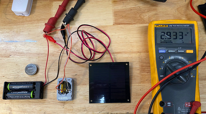

I recently did some work figuring out solar charged wireless temp sensors for SmartThings..let me know if you're interested. It's a very cheap way to gather temp data from wireless sensors with logging from web based data. 100% wireless and because of the $6 solar cell/NiMH replacing internal lithium, the sensors stay fully charged even at -35C temps. About $40 all in including the sensor. Bench test pic:
The sensor is part of door automation so the internal lithium cell pooching in cold temps was not working so well...
