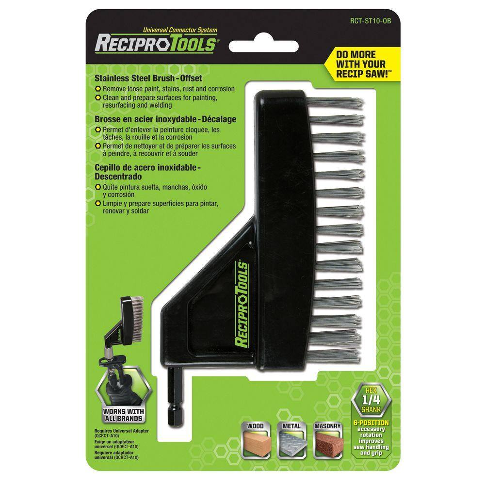

Anyone ever try using one the wire brushes made to go in a recip saw ? Screenshot_20220113-132443.png
I'm cleaning up the rear end on the Mustang and need to wire brush inside the mounts for the lower control arms (LCA).
I can manually do it with a regular wire brush but it's going to take a bit. Curious if it would be worth it to buy one.

Interesting.. Never seen one of those. I wonder how it would do in cleaning paint off my brick fireplace
For 8 bucks, not much to lose in trying

I've seen them online, just not known anyone that has used one. Surely, somebody here at GJ has.
Yeah Mike, for $8, what am I out. . . . Nothing except the 20 minute drive there... might as well buy 2 and use military discount to boot.

Can’t imagine that’s needed for a small job. Also can’t imagine the amount of airborne **** it would create for a large job.

I actually have the one pictured and have never used it.
Me too. Bought nylon and SS, knowing I will need them soon for a grout job. I have had them since Covid started. Bought a rotary nylon one too.
Someone said best to mount them upside down in saw for better brush contact to floor etc.

I own one, I also have the plastic bristled brush. I can't say that I have ever used either one. In fact, I forgot all about them until I saw this thread. I will say the wire brush looks and feels like it will do a hell of a job though.

I've used that one and the nylon as well. They both worked well for my jobs. The metal one I used to scrape paint off metal.

Those do look cool. Home Depot has them with a quick release on end.

I spotted those on Amazon - there's a file attachment too which seems like a neat idea. However, one of the reviews I read said you couldn't apply much pressure because of how far the file sticks out when attached to the adapter. That makes sense - it's like 1/4" hex. If the end of the file is 8-10" from where it attaches to the saw, that's a lot of leverage.
Anyone know of such a thing that doesn't use an adapter? It would be neat to attach a file to the end of my reciprocating saw.

Just saw this and you'll eventually find out how they work for you, but I bought that exact same brand and am underwhelmed. Granted I am using it in a M12 Hackzall so I don't have a ton of power, but it makes it harder to put much force into it. I just end up leaving the wire brush on it and not forcing it which doesn't work as well. Wire brush takes some elbow grease. If you have a corded recip you'll be better off than I was.

I used my DeWalt 20V recip saw.
Impressed ? Not really.
Better than hand wire brushing ? Definitely.
Did it do everything I needed it to ? No. Im working it a pocket but I had assumed as much.
Worth the $8 cost ? I'd say yes.
What seemed to work for me was moving the brush around rather than trying to hold it in one spot.

I appreciate the review.

Eric, I would agree completely with your assesment. I also bought the scraper blades in 2 widths and found that they are underwhelming, can really damage a surface when used at too steep of an angle. They become like a jackhammer on the surface. A variable speed sawzall helps with all of these.

Pretty much in line with what I found. I also got the scrub brush and have used that a bit with similar results.
