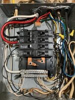

I've always wanted to learn to weld, but just never really had the opportunity/need. That said, my wife wants to get me a welding setup for Christmas and asked what I would need. I've been talking to a friend who recommended the Hobart Handler 140. It gets good reviews, but I do have some concerns about not being able to handle some thicker materials.
I'll try to give some important information, but I'll probably leave something out as I'm a complete noob to welding.
I currently only have 110v outlets in my garage, but I have a circuit breaker box with open spots so I can add 220v if needed. ideally, I will add 220 at some point regardless.
I would like to build some shop projects like workbenches, benches, or garden projects as well as be able to fix cars or other items that break. I am not sure about needing to weld aluminum, but it would be nice to have that capabity as I built my wife a greenhouse kit this summer so it would be nice to be able to repair if something ever happened to it.
Projects I have in mind right now would be to extend the tongue on my utility trailer, add a box up front, and weld on the jack. I would also like to repair the mower deck and make some modifications to the Johnny bucket I recently picked up for my new to me wheelhorse garden tractor. Based on what I've seen I would think something like the Hobart 140 would be good, but some of the metal on the Johnny bucket is 3/8" and the mounting brackets are probably 7/16" thick which is thicker metal than recommended for the 140. I looked at the 190 and 210, but am not sure I need to spend that much. Overall, I'd prefer to spend less as I would need to get safety gear, gas equipment and other associated tools.
I'll add some pictures of the Johnny bucket and my panel. I've read some and watched some YouTube videos, but figured there's always great information here so I wanted to ask here as I love watching all the build journals here. Thanks in advance!

You've already identified metal thicker than what the 120V machines can really weld.
Get the 240V machine now and skip the whole 'upgrade later' dance. :lol:
Safety and miscellaneous gear: helmet, gloves (plural, so that you have more than one pair available for when you burn or rip a hole in one pair :lol_hitti ), welding jackets (plural, I like at least a leather one for more protection and warmth in the colder weather and a thinner fire-retardant cotton one for hot weather and when more protection isn't absolutely needed), grinders (plural :D), various sizes and types of clamps, etc.
The 210-class machines can do pretty much anything a 'home' person would want/need to weld.
The 190-class can do a lot, but not quite as much as the 210-class machines.
The 120V 140-class machines can do sheet metal pretty well with GMAW (aka MIG), and some thicker steel up to about 1/4" thick (usually) if using FCAW wire.
General rule-of-thumb for wire welding (GMAW) is 1 amp of welding current for each 0.001" thickness of steel being welded. 1/8" steel means use 125 amps of welding current, give or take a little.
And NO, you can NOT just make multiple passes to weld thicker steel. You NEED enough power in the welding arc (amps mostly, but also the arc voltage matters at least a little bit :lol: ) to PROPERLY melt not only the welding wire (which will always melt, unless you REALLY screwed something up in setting the machine up) but also the base/parent metal being welded.
Otherwise you just piled melted wire globs ONTO the surface of the base/parent metal.
Called "cold lap" or "lack of fusion" or "lack of penetration", among other things. "Bird poop" for when the attempted weld is REALLY bad. :lol_hitti
Go check and read up a whole bunch on the Lincoln and Miller and ESAB websites about welding and how to pick/choose a 'first' wire-feed welder.

You really want the 240V machine. If you ever weld aluminum, you'll need WAY more amps than a 120V machine can handle. Nobody ever said ``my welder is too big!''
Take that deadfront off that panelbox and make sure there is provision for breakers under those knockouts. There may not be.

Also, so I can price materials to add a dedicated 240v outlet what amp eating plug should I be looking for? I know part of this will be dependent on the specific welder I choose, but I'd like to get a good idea of materials and cost. I'll add some pics of my sub panel in my garage. I should be good to add a 240v breaker.

All the 240 use 6-50. The advantage is 2x the power of a 140. It will run 030 solid wire, it's a lot bigger than 023. It is easy to wire so the circuit isn't at max with every arc. They are legal on circuit to 50A depending on wire size a 10 wire 30 breaker is a tailor made, they are small machines and that gives them all the poop they can handle.

Get a 30 breaker, 12 or better wire to 6-50 receipt, few minutes work to install this. I tend to use 10, partially cause I can and it makes for more robust connections. Also has the potential to serve 50A if needed.
